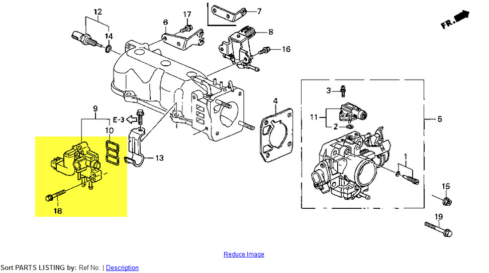

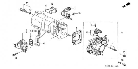

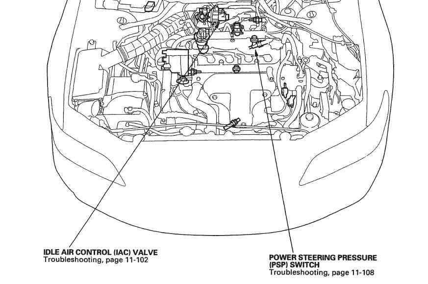

I have read the sticky on this and I beleive this is my problem as I get the p0505 code and it will not idle. I have a 2000 accord coupe with the 2.3 and 5 speed.
Can anyone tell me where it is? I see the map sensor on top and I think the throttle sensor is just behind the throttle body.
Thanks for any help.
Stephen

Old Mar 25, 2014 | 10:15 AM
IACV is #8 in this picture, maybe easier to see in this view. It actually bolts to the intake manifold very close to the throttlebody.

Old Mar 25, 2014 | 11:20 AM
Here's some more pictures. One picture is the same as what JimBlake posted; but, a little larger sized image.
Attached Thumbnails Where is the IAC?-iac-valve-1.jpg   Where is the IAC?-iac-valve.jpg
