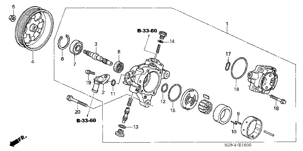

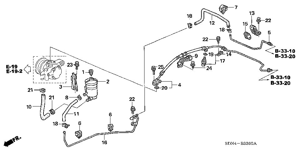

So I took a peek in the fluid reservoir while running and the fluid is a bit low and bubbly, but not really foamy. I'm going to replace the orings, and flush the fluid sometime this week. See attached images, what oring(s) need replacement?
Attached Thumbnails Whinny power steering-lineoring.jpg   Whinny power steering-pump.jpg
Old Dec 16, 2013 | 05:19 PM
EXV6NIGHTHAWK's Avatar
Joined: Mar 2007
Posts: 710
It's the hose going from the reservoir to the pump, and the o-ring is at the pump end of the hose. Here's a DIY someone on another forum did. If you have any questions, just ask.
