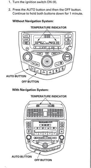

Does this have auto HVAC control.....can you pic out what your controls look like from these pic's?

yeah, the first one looks like mine. Is that the instruction to do the diagnosis? I performed the diagnosis described in that diagram and when I held the re-circulation button and pressed the rear defrost 5 times the re-circulation button blinks a couple times and the vent light (next to max ac) went out and the ac button light and defrost light come on and the blower started blowing... after a few second the ac and defrost lights went out, the blower stops and the vent light (next to max ac) comes back on.
It didn't seem to blink out any coded diagnosis, what do you think? Thanks for going above and beyond to help me. Thanks also for serving our nation.

Yes those are the instructions on how to get the codes without HDS. Sounds like the system was going thru the testing (blower comes on and a few other things), where you holding the buttons the whole time? Also the temp read out is where any codes will show up - you look for which segment of the read out lights up....again everything could be fine....we are just wanting to be sure.

yeah, I held the buttons down till well after it stopped doing its thing.... Mine doesn't have a temp readout though.

Ok, sounds like you have manual HVAC controls - no digital read out on temp.....give me a bit somewhere I have those....or someone else might chime in with the answer.
Again, I wouldn't worry too much about this....it is a check to be sure the wires don't "fry" again.
