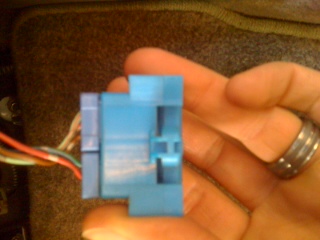

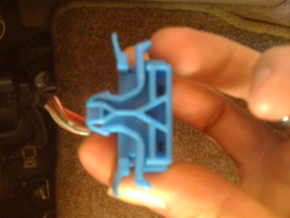

This is the service connector, right? Nothing seems to happen when I jump the connector

That is not the connector.
The connector is under the glove box. See the dhost link that I put in the DIY writeup.
Where did you find that connector? What did it plug into?

I looked closer. That is actually the holder that the 2 pin connector sits in and clips up under the glove box.
I jumped the connector and the check engine light just stays on. It does not blink at all. However, the ABS light throws code 18. . .

You are right for that holder. I didn't recognize that.
