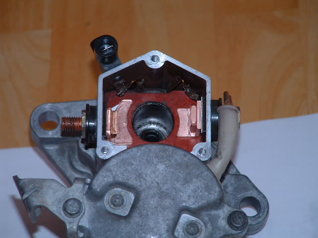

So, when you try to start the car the engine doesn't turn over? If so then there's something wrong with the starter or associated circuitry. A common problem is worn copper contacts, which would cause the starter to click but not turn:

Ah, wait a minute. I missed that part. Good catch Roader.
If the starter doesn't crank the engine over, then your problem has nothing to do with the main relay.
When it doesn't start, try the caveman test. Hit the starter with a broomstick while someone is trying to start. If that makes it work, then you need a new starter or fresh contacts in the starter.
