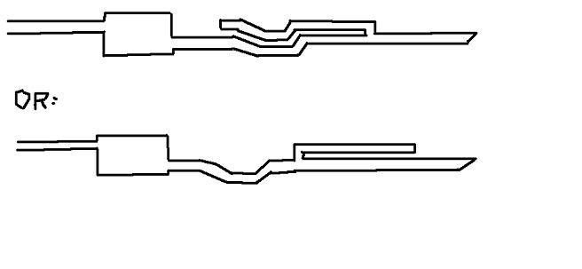

two times per revolution. That's what I was confused about. Well, at that frequency you're losing the sub-bass frequencies in your music and that just sounds annoying. Attenuating that is a bit beyond my knowledge level. I'd say go for a branch resonator because of this.

This is my final attempt since I dont wanna go back to stock yet. It shouldnt be too expensive to put this together. I just need to find the materials. Its harder than it seems. Especially capping off the end.
Ive read that it is suggested to put it on the tailpipe after the muffler. Like shown in the drawing. I have two tailpipes that dont go out very far. I think I can go before since I also have a glasspack near the cat.

Threaded piping, with caps maybe? And I would have thought a 4 stroke 4 cylinder engine would only open the valves once per revolution, but I may be wrong.
