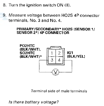

With ignition ON, check voltage across the 2 terminals as shown on the wire that plugs into the sensor. Should be battery voltage when the ignition is turned on.

Thanks for the reply.
I did check the resistance for the new o2 sensor heater element and it tested fine before I put it in. I honestly didn't even think about checking the line going to the o2 sensor to give it power (oops). I get back into town later this week and will update with results from testing that.
