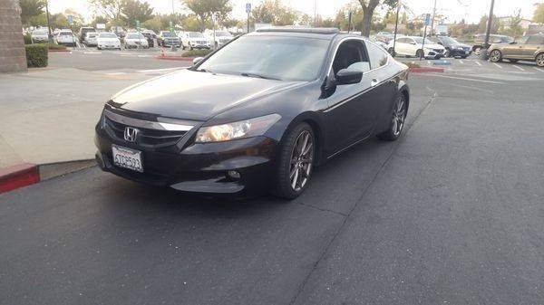

Hello everyone!
I am in the process of purchasing a 2011 Accord Coupe V6 MT with an HFP package. Super rare find from what I'm hearing and I'm ecstatic. I have a few questions:
I'm struggling to find out what exactly is in the HFP package. What does that include on top of the normal options?
The seller says it needs a new clutch soon. Is it worth upgrading? And if so or if not where can I go to obtain a new clutch/clutch kit.
I also want to do minimal modifications to this car but I definitely want a louder exhaust note. Unfortunately I am in California where regulations suck. What is my best option for making this car louder without creating hell for myself in California and where is a good place to purchase?
Also is there anything that normally goes bad on this car that I should look out for soon? Car has about 120K
I attached a pic below:
Thank you!
