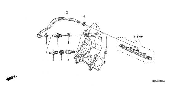

Now, the one I wanted to talk about - this PCV valve. I saw elsewhere on this board that it costs like $3. How critical is it that I replace this? How can I confirm I need to replace it? I don't have a CEL indicating it's broken (yet).
Can I do it myself? If not, how much should I expect to pay to have someone do it?

Here's a picture of the breather hose. Say you're standing in the center of the front bumper, looking towards the alternator. This is the alternator bracket, and the PCV valve is #1, screwed into a hole in the alternator bracket. It's not as simple (or cheap) as the older Accords with the plastic PCV valve that pops into the valve cover.
You test the PCV valve by removing it & shaking it. There's a spring-loaded plunger inside that's supposed to rattle. If it's plugged up with sludge, oil, & crud, then replace it. Think about a new hose too.
Also.... the timing chain is not a normal maintenance item. But there is a way to measure how far the chain-tensioner is extended. (I don't think it's a roadside job) If it's beyond the acceptable range, then it's a pretty big job to change the chain.
