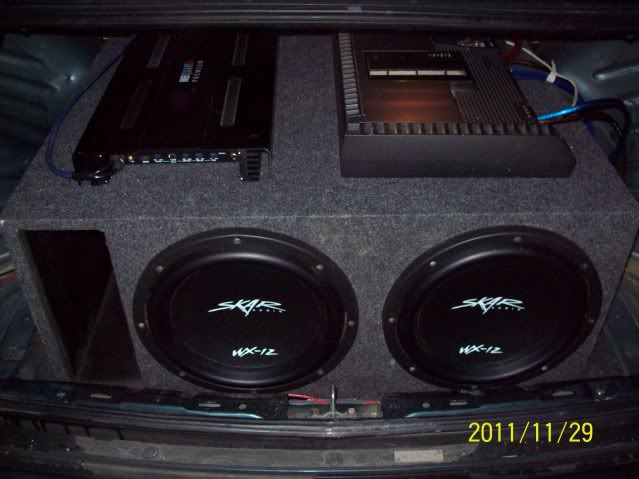

I do not see 15"s working in your car unless you run them in a box that is too small for them. I am running a pair of 12's and the box takes up the whole trunk. Without building a box inside the trunk (which is a total PITA) there is no way to get the proper airspace.
Also what Fosgate Amp are you going to use that produces 2,000 watts @ 4 ohms? I am pretty familiar with the whole line-up and they do not have an amp that will do that.
I am running a fosgate BD series amp and have 1,500 RMS @ 1 ohm. I strongly suggest researching what upgrades are required to run that level of power. I have done the big 3 with 1/0 wire. I have a H/O alt. 2 large runs of power wire to the rear. I run a voltage meter where my ashtray used to go to monitor voltage and I have to watch it closely in order to make sure it doesn't drop into the 12's while pounding hard. Those large Fosgate amps are power hungry.
Here is a picture of my trunk, you can see that there is no real way of getting a larger box in. Those are 2 - 12's in around 6 cubic feet tuned to 30 hz

there is not really enough room for a 10 cubic ft box in that trunk.
Dont be one of those people who shove large subs in small boxes just to say they have them even though it sounds like poo. Where I moved from all the guys running around in Donks would put like 6-8 12's in there trunk and it sounded like azz.
