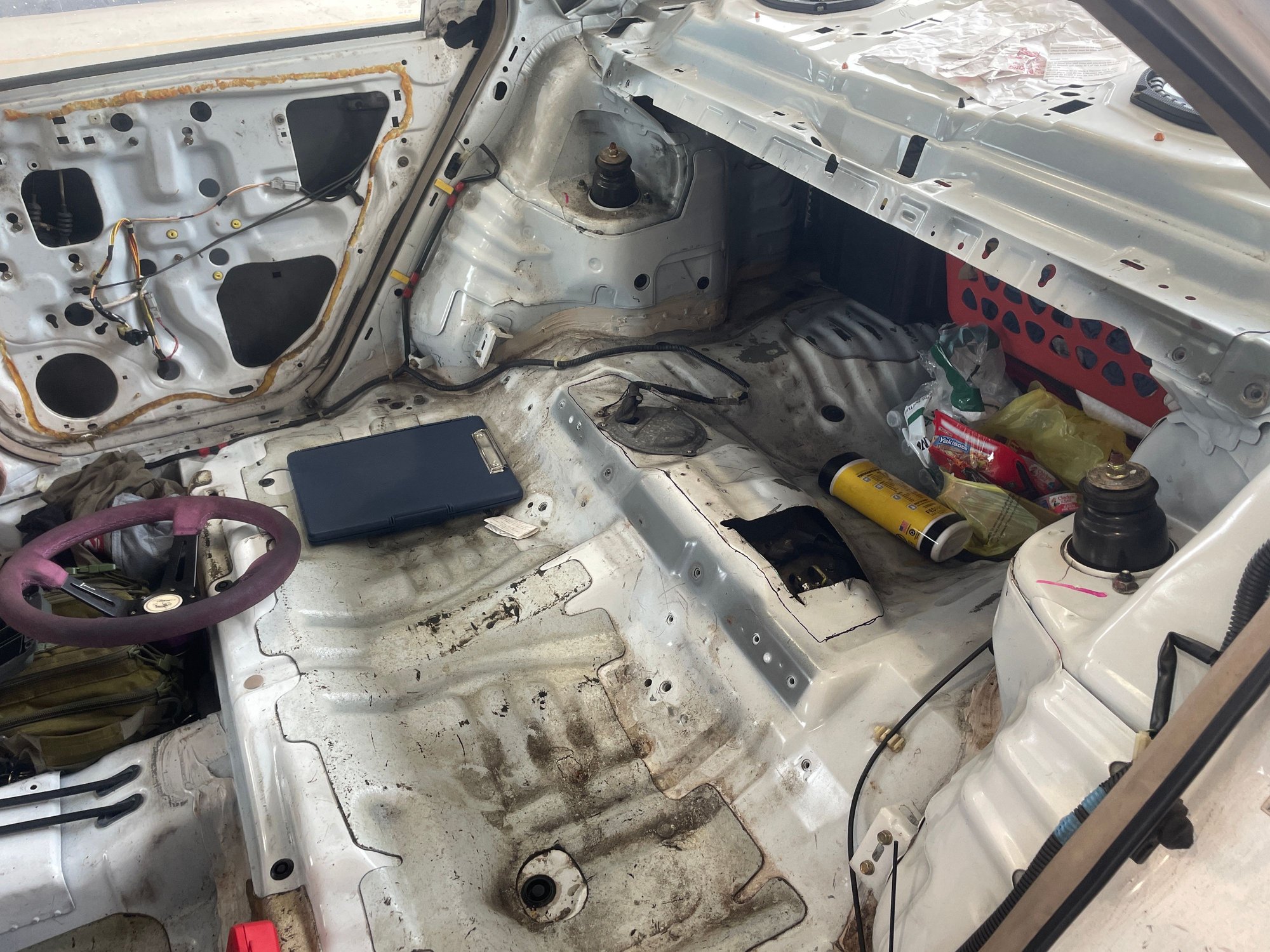

My son bought this car and at some point, I realized the shape it was in and how unsafe it was and when I got under it, there were bolts missing everywhere where, it leaked brake fluid, had a bad wheel bearing, essentially it was a death trap. Long story short, i started helping my son make repairs and discovered I actually really really love working on this car.

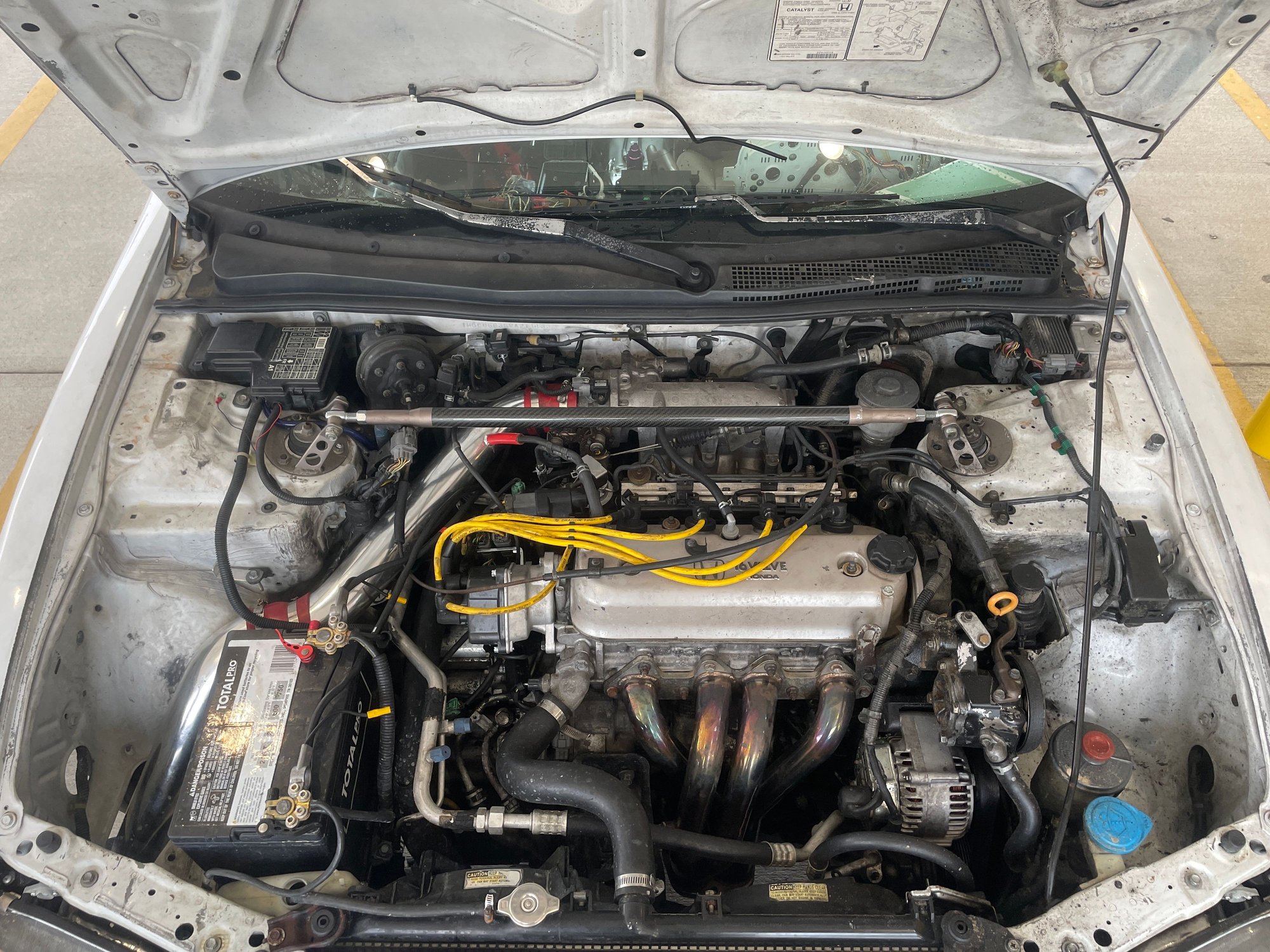

now I have been bitten by the bug and have developed a bit of an obsession. I bought it off of him, ripped out the entire interior, have swapped the front axles out, replaced the brake line, replaced both wheel bearing hub assemblies and updated the ignition system with new ngk itidium plugs, dragonfire wires, a new oem coil and distributor, a stainless 4,2,1 header has been installed. It has a cat back exhaust (unsure of brand), NRG quick release and a racing steering wheel.

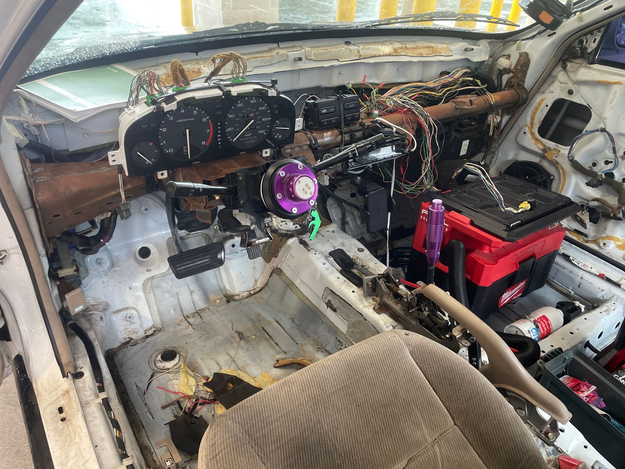

I am currently going through the wiring and harnesses, to clean it up. I am eliminating anything and everything I don’t want or need.

I’d like this thing to be clean as a whistle but not aesthetically in the sense of putting door cards or carbon trim pieces. If it can come off, it should come off and stay off. I am a bit of a weight weeny and I can’t stomach adding anything back after I remove it.

1. The cluster is erratic and it seems to be related to the harness plugs, wiring or plug jack. I constantly have to mess with it when driving so the tac and temp gauge read correctly, having a difficult time getting the fuel gauge to run accurately and consistently. Something I will pull the sending unit to visually inspect how much fuel I have. Would be fine eliminating the sending unit unit and gauge if theres some way to replace the sending unit housing with a window, so i can just look in and see what it has. Simple is the top priority. The less things that can go wrong, the better. Cluster will be updated with digital screen at some point, so not too worried about a permanent fix.

3. The damn heat shields rattle. I temporarily fixed it by stuffing heater hose all over trying shield it from the body, eventually going to remove heat shields and just wrap the exhaust where necessary.
4. Oil leaks. Corner oil pan bolt broke off so pan dumps oil the most while idling, crankshaft seal likely leaking as well. I have a timing cover seal currently but i am not sure if that is the seal i need or if it’s a secondary crankshaft seal of sorts. Presently I just dump oil in her because she’s a thirsty b****. I spend more on oil than gas at the moment keeping it on the road and oil changes occur every couple of days as a result, 😆
