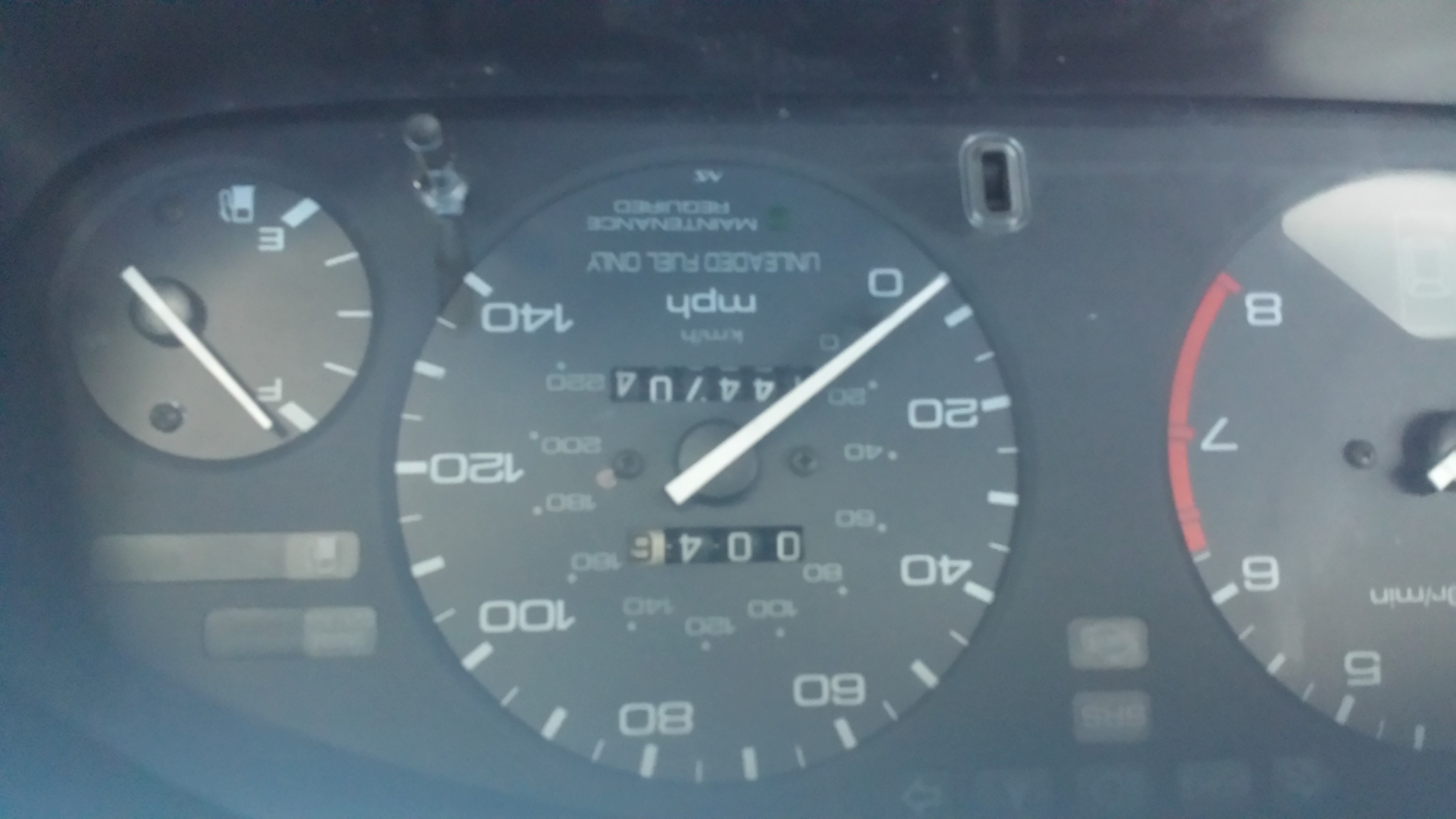

Thanks man, that was my thought exactly. I pulled the cluster, disassembled it and removed the speedo and figured since the odometer is frozen I'll bench test it. By moving the tripometer backwards the odometer rolls backwards too, however the tripometer rolls forward only .4 miles and when the odo tries to roll to 144700 it freezes both odometers. I'm guessing that this is why the odo doesn't work. Why does it seize at rollover?
This isn't the first time it froze trying to rollover.
I didn't go to crazy with the heat gun since the speedo works, just inaccurately.

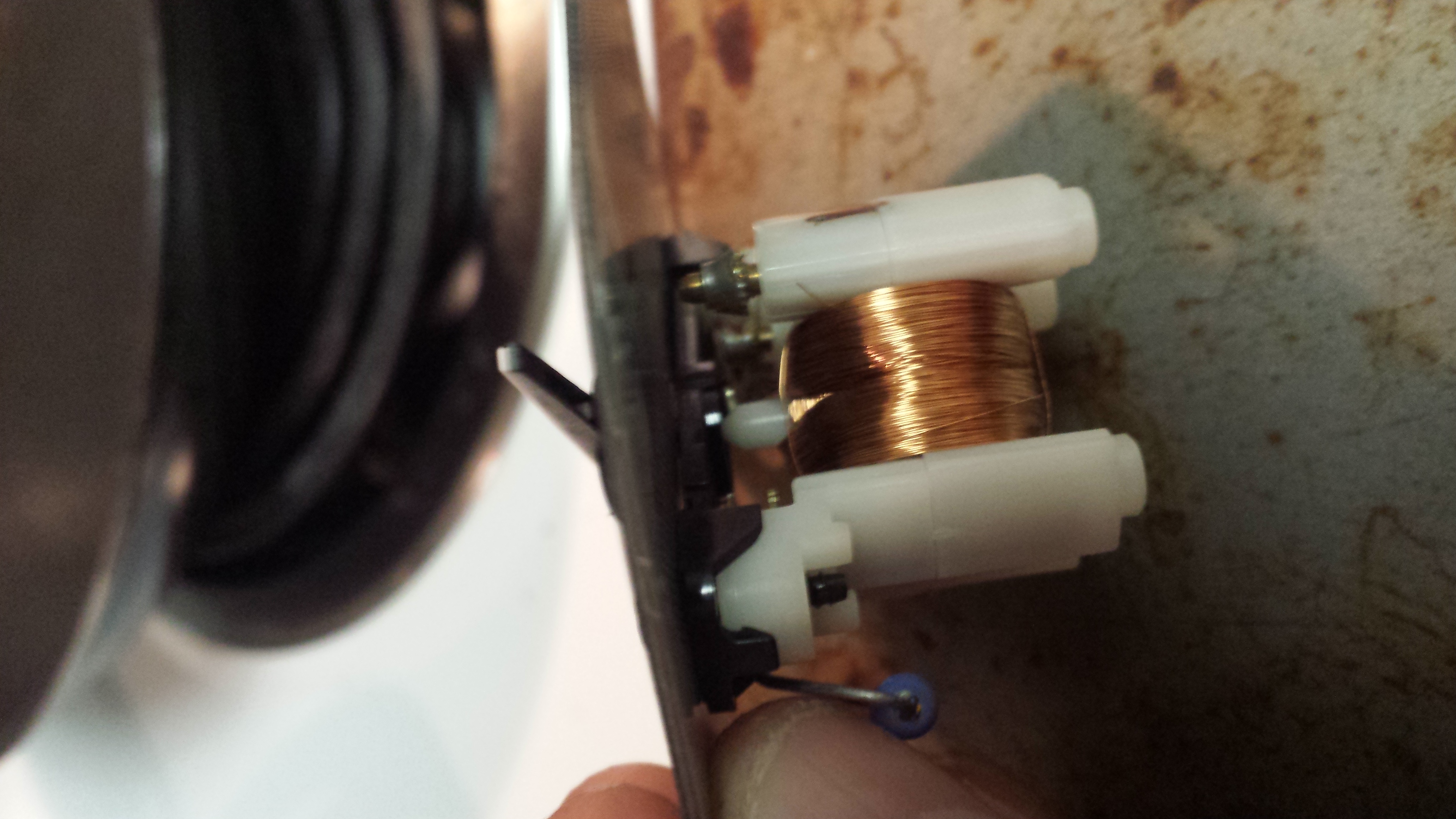

Off to the gas gauge, I was told by a honda tech (close friend) that it's most likely a wire between the motor and gauge itself, that's next up.
Edit: I found the broken wire
If I were to be lazy, could I just wrap a piece of speaker wire around both points, or should I try and solder it?
Any advice is greatly appreciated.

It goes without saying that it is your car, so obviously the final decision is yours alone. What line of action do you feel would be best?
Adding a 'wrapped' wire could prove to only be a temporary fix... and possibly lead to other issues down the road
If only temporary worked haha, it didn't work at all but that's ok, I'll replace the gauge. I'm terrible with soldering, it will probably be more stress free anyways.

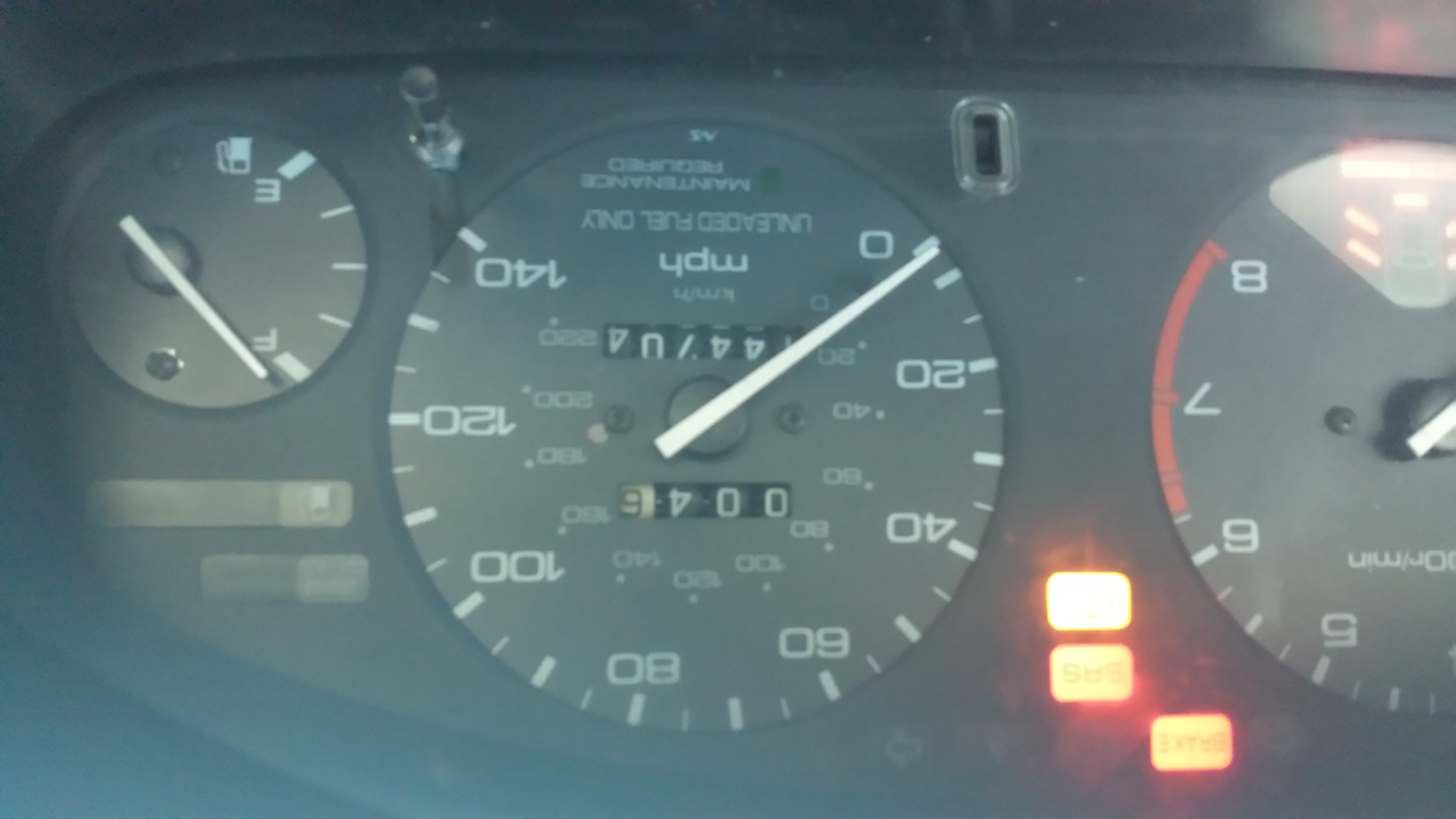

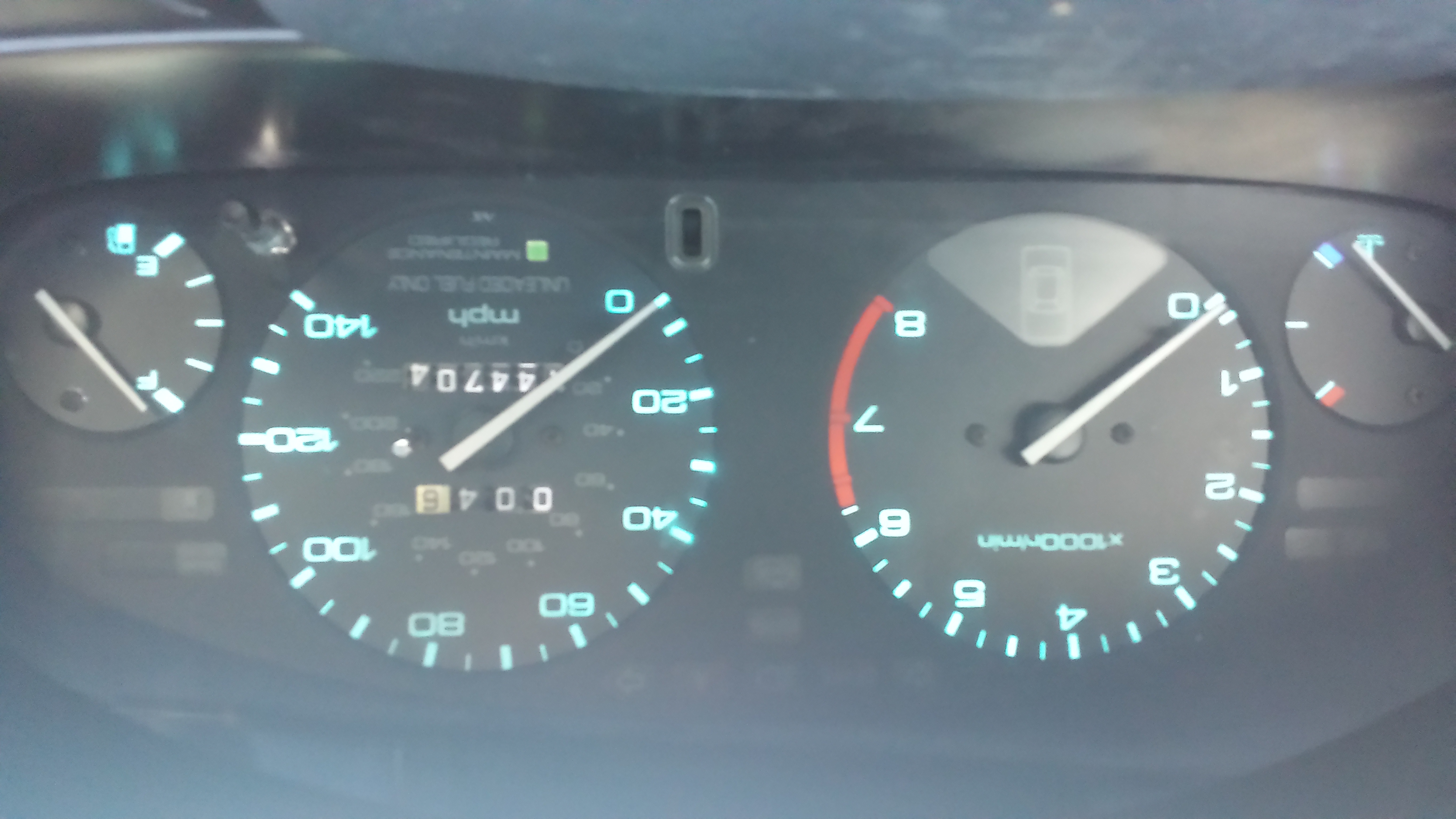

The speedo still feels off, I also noticed that when the key is on the speedo moves slightly.
Key off engine off
Key on engine off or engine running
Just slightly, probably need a new one of those too.
