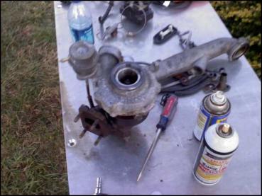

Doing a junkyard turbo kit on my accord. I'm gonna try and post as much as I can along the way. I'll probably put it somewhere else in the forum, but here's where I'm starting from.
1999 Accord Coupe Ex
F23A1 w/ Manual Trans.
18x8 Kyowa 626 Black Wheels
Cheapo (wheelsNext.com) Nankang Tires
AEM Short Ram Intake
I just got a busted up Garrett T25 from a Saab at the junkyard yesterday WOOH! So now I'm gonna try and rebuild it and get it working. I've got a P28 ecu that I chipped with a kit from moates.net and converted it to manual (it was originally out of an auto). Tested it on my friend's 95 civic ex manual and it worked great. I got an Ebay OBDII-OBDI conversion harness for the ecu and I've also got a Innovate Motorsports LC-1 Wideband set up. I will be tuning with Crome. My friend also has an Ostrich emulator and a chip burner.

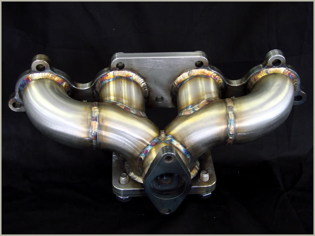

Next on my list is a Weirtech exhaust manifold flange and turbo flange and some mild steel bends from Columbia River Mandrel. I'm gonna weld up a manifold somewhat uglier but similar to the one pictured below.
