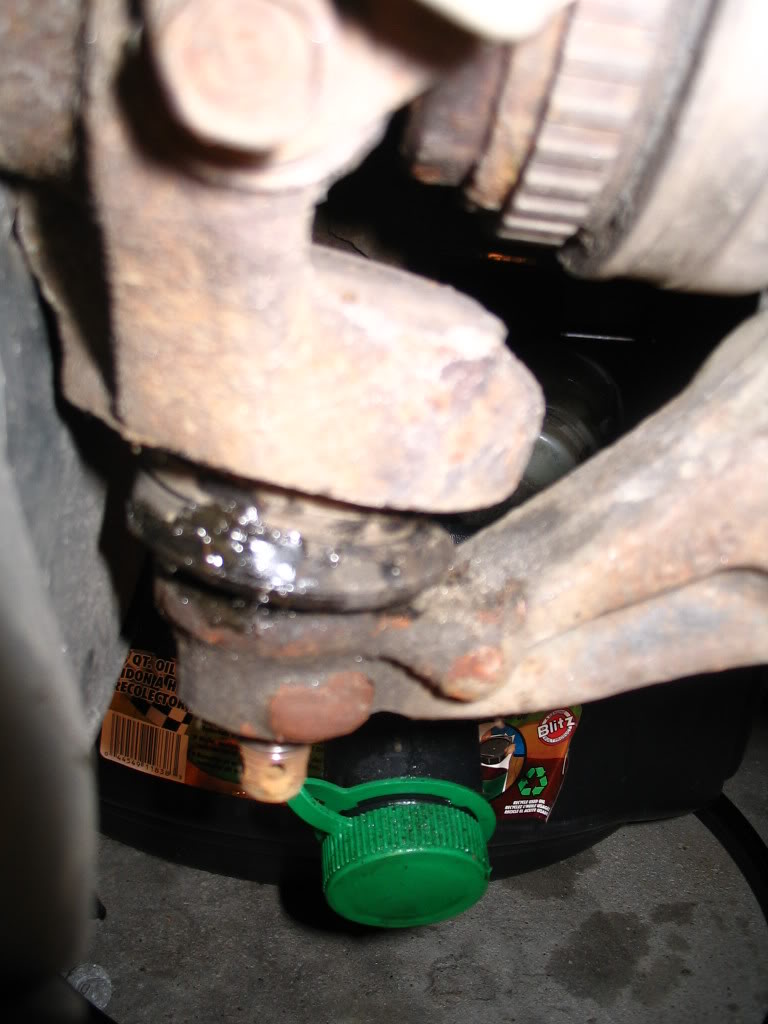

seperating a ball joint.............how do you do it lol

twist the screw thingy? let me take a picture then you tell me what to do.

I have a ball joint seperator, just not sure where to hammer it in, and when to unscrew what.

Okay the castle nut is off, thats good!
Is it a screw type remover with two forked arms on it or is it just a pickle fork?
Pickle fork:
With the separator you want the forked arm to go against the hub, so stick it in between the bottom of the boot and the top of the lower control arm. Then, put the not forked arm on the bottom of the stud. Sticking the castle nut back on would be a good idea so you dont fawk up the threads.
I can draw on your pic if you need me to...

yeah i'm still a little confused..............I have the fork one. so I pry it in between the lower control arm and the ball joint, then push down on the handle so it pushes it up/push up on the stud?

Pickle fork? Pickle fork just goes between the hub and control arm... I havent had much luck with them, they like to destroy the boots.
I usually just hit the stud upwards a few times and it comes free.
