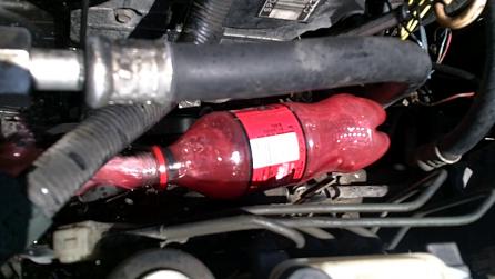

Today I flushed the power steering and learned that even though the jug is empty, the pump and lines still hold a lot of fluid....
Attached Thumbnails What did you do to your Honda today?-vlcsnap-2014-05-05-12h36m10s68.jpg
