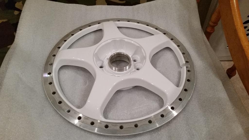

Picked up the faces of my new wheels from getting powdercoated. First step to getting them on the car.
Now to repair and clean all the lips and barrels.

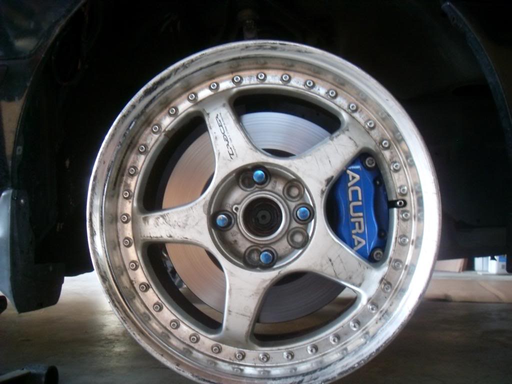

And a before picture for reference lol

If you don't mind.....what did that cost?
The place I go to charges $220 for powdercoating a set of wheels.
I'll be spending another $300 or so in repairing the outer lips and inner barrels of the wheels. So $500ish for a complete restoration.
All in all, I'll have about $1200 invested.....$500 in refinishing, $400 for the wheels, and $300 for a brand new set of center caps.
