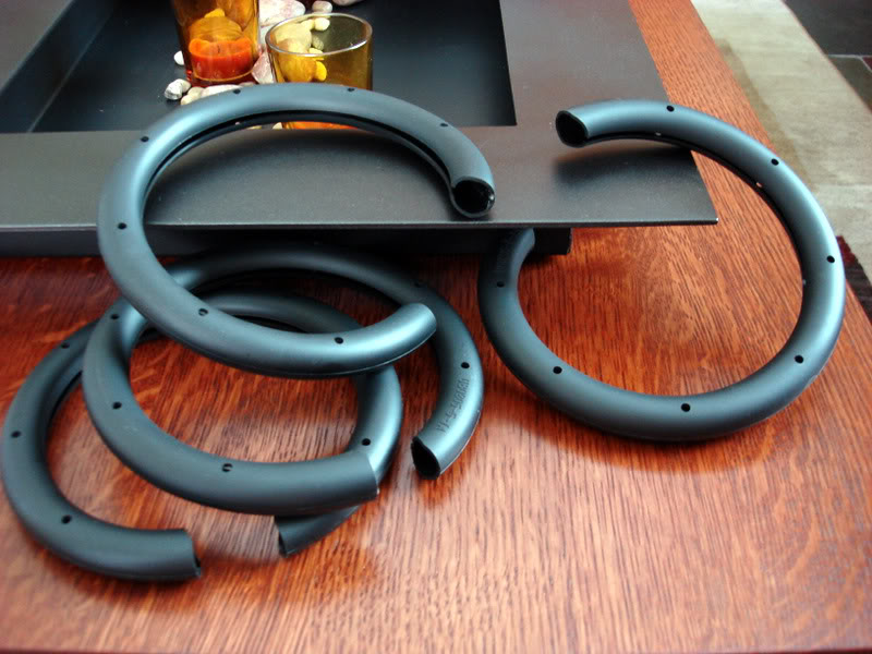

The insulators came in the mail (sample pic, but mine look exactly like these except mine are 3/4 circle instead of full):

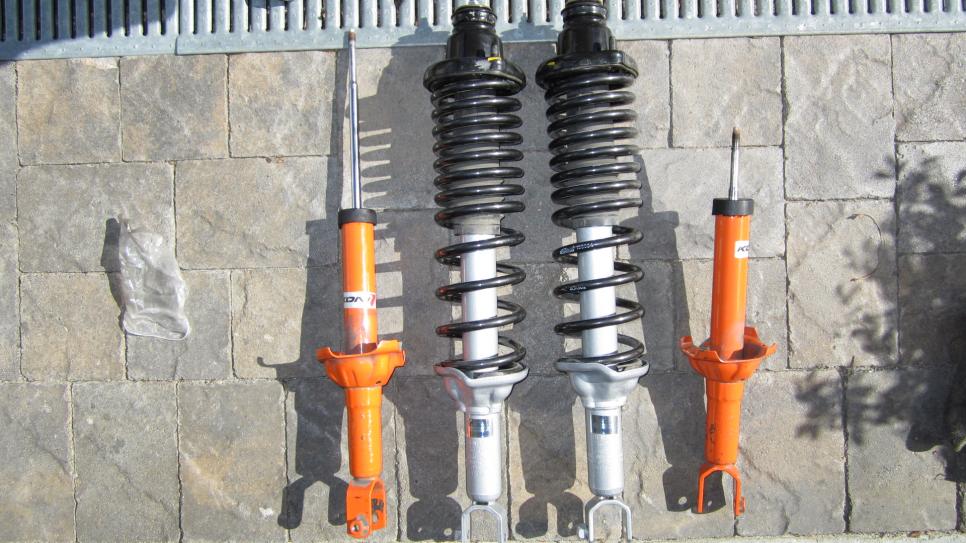

and clipped onto the springs pretty easily. I was given three for each spring, and I placed them on the 2nd, 4th and 6th coil from the top. My rear springs have a lot of coils in them -- here is a pick from when I swapped shocks a couple of weeks ago (... keep in mind the 1st coil is under the cap):
Well, good news -- the insulators completely stopped the noise. So it was the closely spaced coils that were vibrating and banging against each other and making an awful racket.
