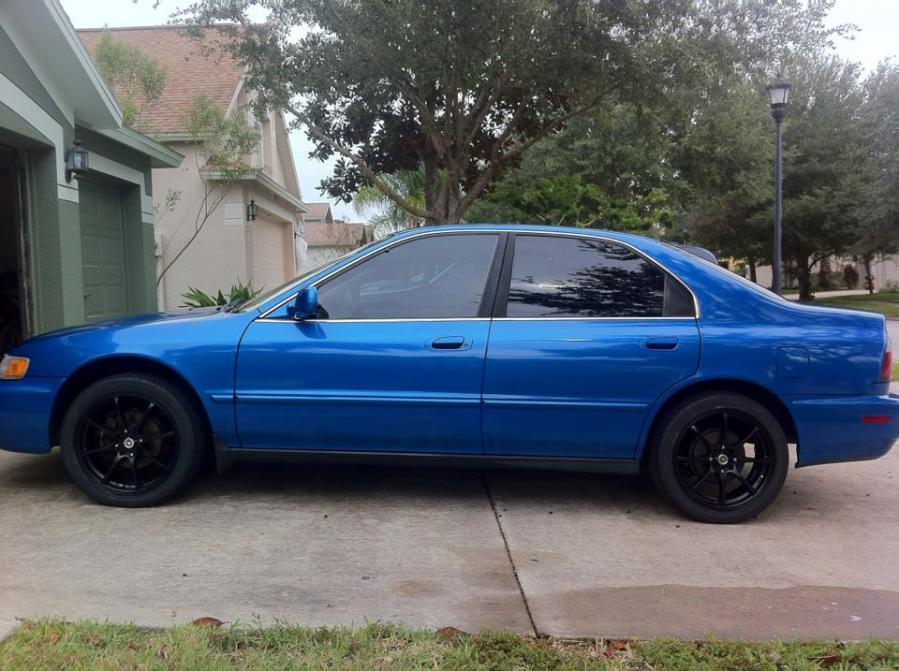

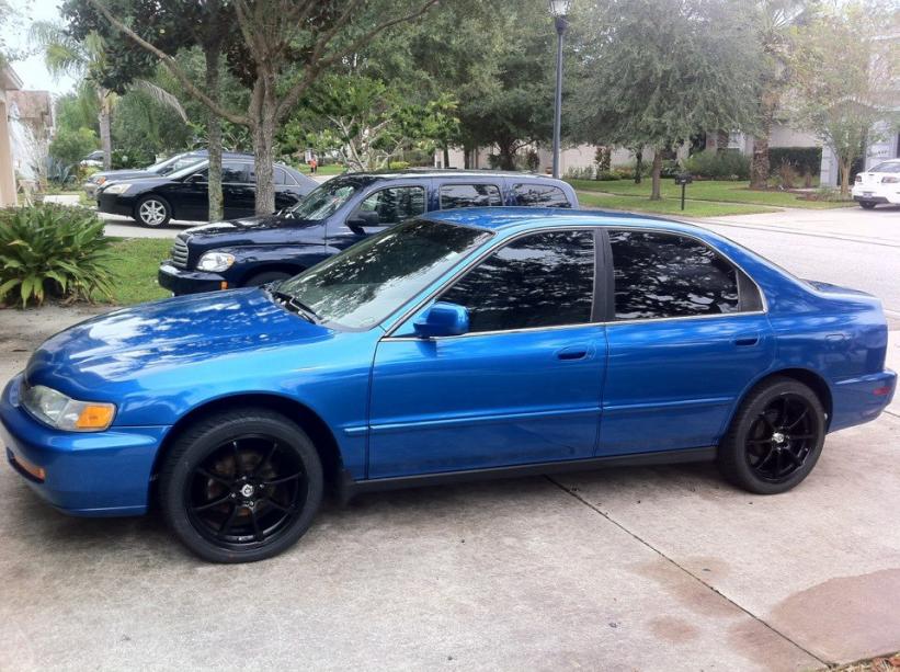

Hi everyone, I have a 97 Accord LX (CD5). It sits pretty ugly and I was wondering what set up I should go with, without spending an ungodly amount of money if I can avoid doing so. It's got 93,000 miles on it btw (crazy right?! ) and I'm pretty sure I need shocks or something first, whenever I go over speed bumps I can hear somewhat of a creaking sound. My main question is what do I need to get my wheels flush with the car? Coilovers? Lowering springs? Struts?

What is your budget? Coil overs are definitely better than struts and springs. Function form cool overs are the best bang for the buck.
