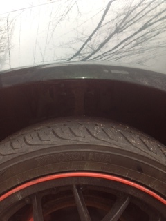

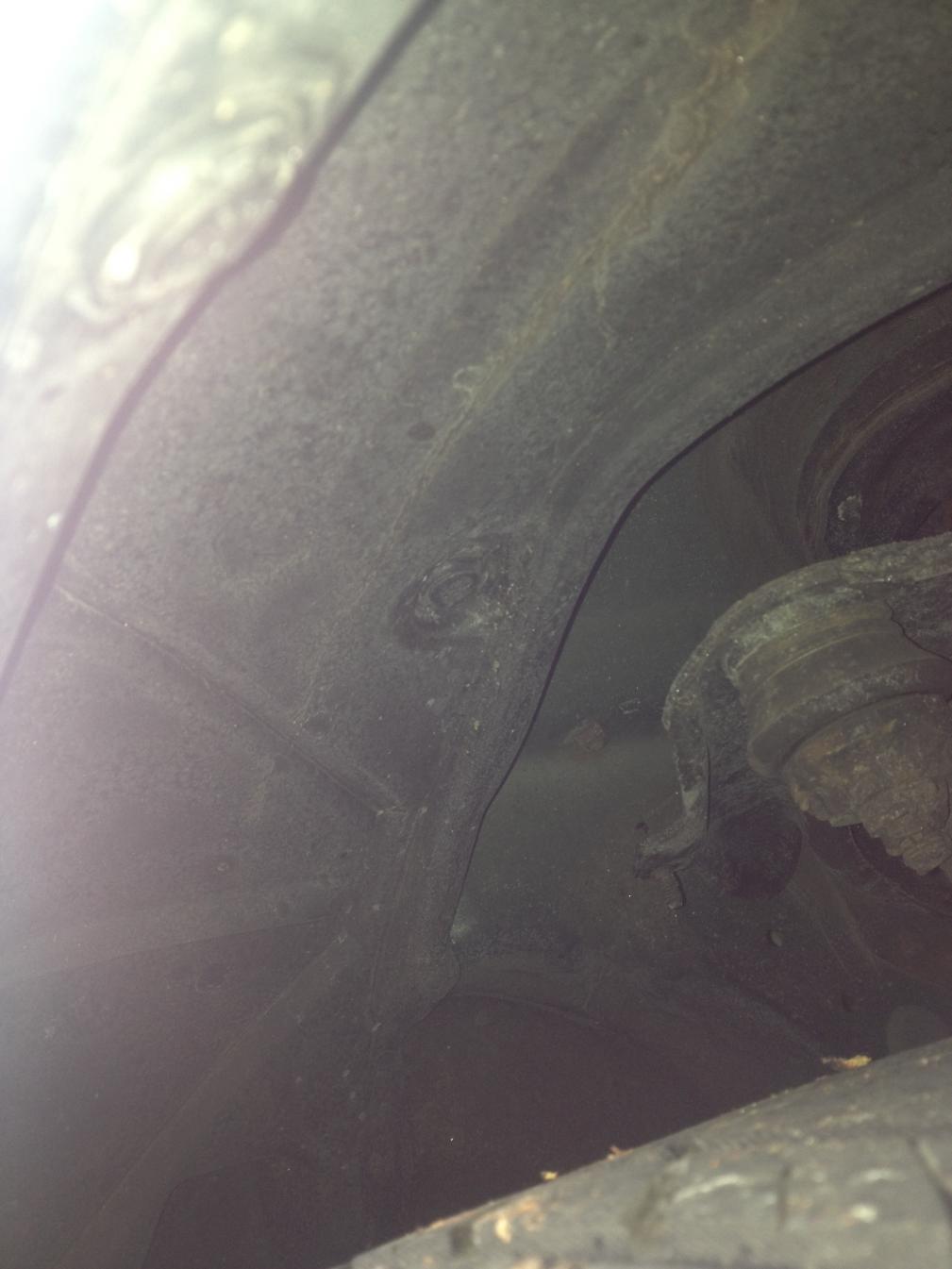

Okay so this is what my tires say on them. 215/45R17 87W
Of course I dont know what this means lol
This is a pic up under my front fender above the tires. Thats what im scared of my tire scrapping on.
This is the gap

How low do you want to go? That's the biggest
And since you don't want to spend a ton of money, I would suggest Function&Form Type 1 coilovers. Definitely the most bang for the buck. You can find them as low as $530-550 shipped online. That's cheaper than you can find a brand new set of (good) springs and shocks. For the price, they ride decently well, and because of the design, they don't get bouncier the lower you go. ANd you can go un-drivably low on these lol.
