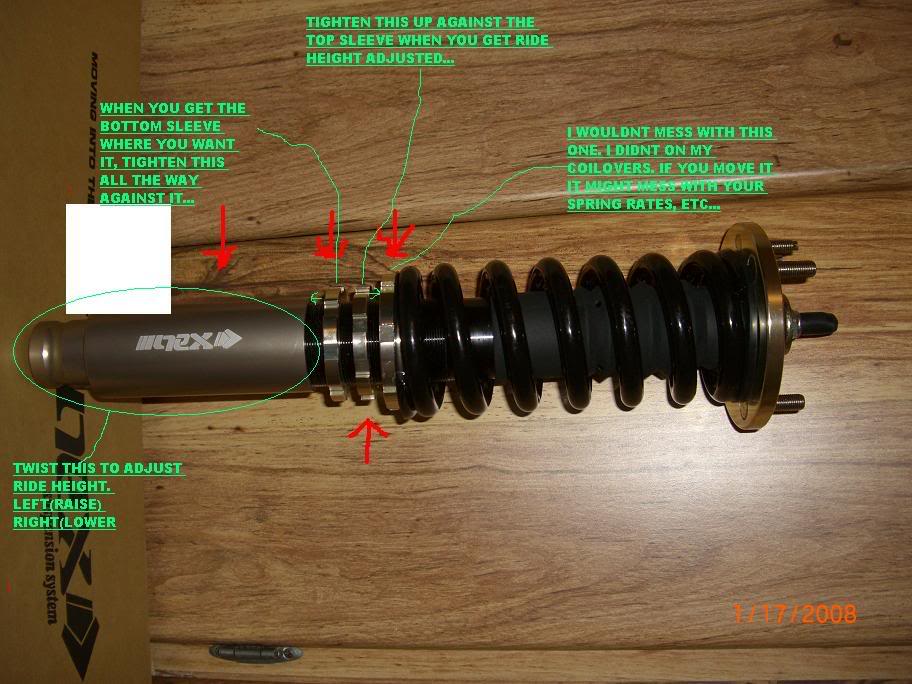

I'm new with this coilover suspension set up can someone explain to me how to install them cause i see that the bottom sleeve is adjustable then i have three rings in the middle then the spring on top ? Does the bottom sleeve needs to be all threaded in ? remember guys what i'm trying to do here isto coverthegap between the fender and tire same on the rear. Thanks
[IMG]local://upfiles/8971/5F49B997598C407D974BAF3F93212FB6.jpg[/IMG]

That looks like the one for the front. The bottom just sits in a hole and requires no bolt, nut etc... Youll see what im talkin about when you have the old one off. As for the adjustment and sleeves, depending on how low/high you want the car, you twist the bottom part to the left to raise and to the right to lower the car. You tighten up the middle sleeve up to the top sleeve so the spring rate is messed with... DONT ADJUST THE TOP SLEEVE THAT HOLDS THE SPRING.... Heres a detailed pic

Only thing I'd add is to turn the top perch a few turns if you can to help preload the spring. Thats what the manf recommended on mine.

J_man .... as BCK mentioned, in the picture above, the words "spring rates" should be replaced with "preload"
I'm a nitpicky bastard, aren't I! ..... just don't want others that are reading to learn about the systems to get confused
