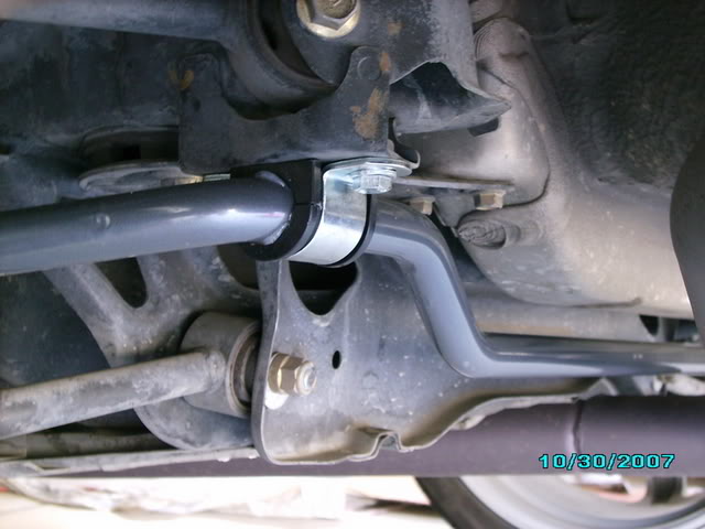

well here's a pic of the 04 TL progress sway bar. I couldnt get a better pic because my jack sucks, need to get a new one.
Progress Sway for the 04 TL application (24mm)

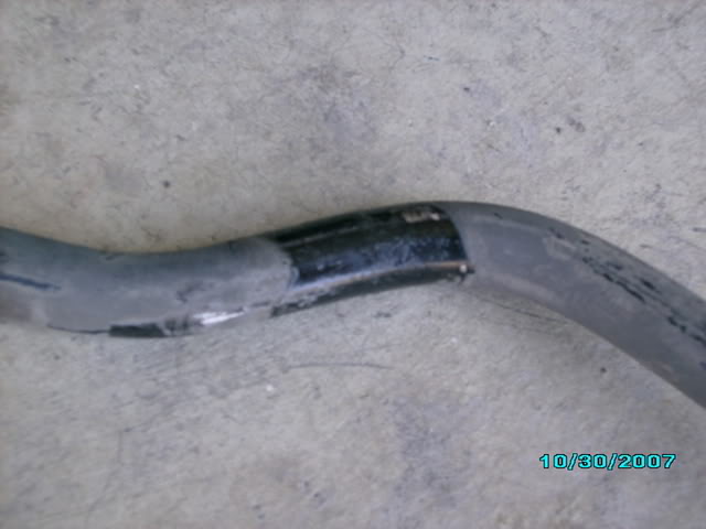

And here's a pic of our stock one (17mm)

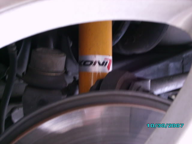

and....my konis

Dang! That thing is thick. Is the v6 one 17mm and the one for i4 is 14mm? Your stock one looks a bit thicker than mine. Then again it's just a picture i'm judging that from lol.
