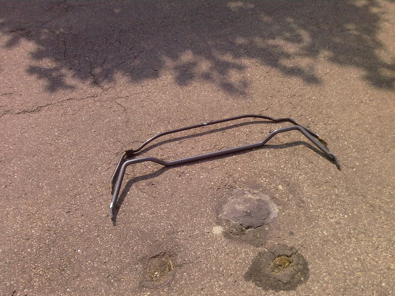

no, i think both the v6 and i4 have the same diameter for the sways.
The only reason the stock one looks bigger is because I zoomed in on it, but here's a picture from another person comparing the progress one to our crappy stock one
Also, there are 2 types of setting on the progress sway bar. The first hole where it attaches to the car is for the sofest setting ( I'm on it right on) and the second hole is for the firmer setting. I think I'm going to change it to the firmer setting. But the difference is night and day.

The installation isnt difficult, you just have to have the time, which I didnt in this case, and some wd-40 to loosen up the bolts. And no modifications necessary.The one I bought are adjustable meaning I can set it to soft or hard, hard leans more towards less body roll when taking sharp corners unlike the soft setting. I just bought the rear.
