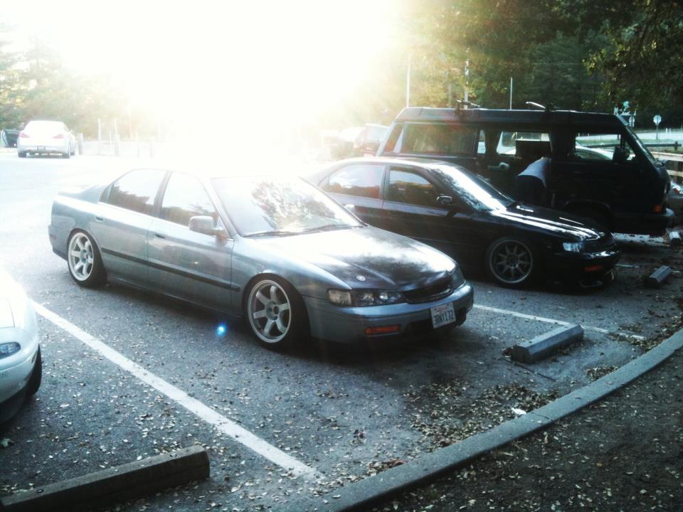

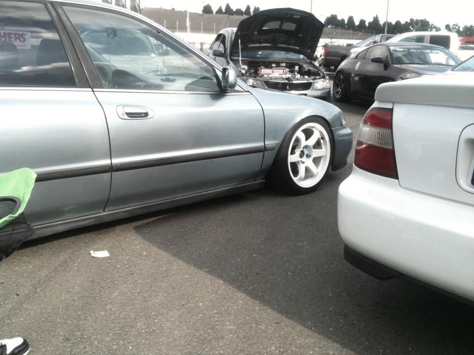

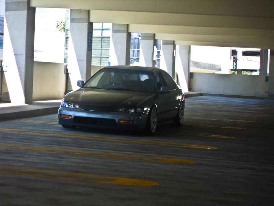

You are gonna need to do some work to fit those specs.
First off. You suspension won't be low enough to fit the wheels properly. With Pro-kits, the wheels will stick out quite a bit. You will need to drop the car around 2.5" or more to get enough natural camber to properly fit the wheels. So you will need a set of coilovers to lower the car that much.
Secondly.....225/45 tires are WAYYYYYYY too big. You will rub like crazy, especially up front. You are going to want to run a 215/40 (little bit of stretch) to not rub. Also, a 215/40 on a 17 inch wheel keeps the overall diameter very similar to stock wheels, so the speedometer will read accurately. a 225/45 would throw it off quite a bit.
In addition, you will need to get your fenders rolled for extra clearance and decreased rubbing.
Here is a friend's car with properly fitted 17x9 +25 Rota Grids.

Nice thanks a lot bro really helped out now last question does it bottom out. Front fenders are rolled already cause in the past I had 8 1/2 all around with a 2.5" drop
Old Jun 19, 2013 | 12:37 PM
hondafreak91c's Avatar
Joined: Aug 2009
Posts: 413
From: Chino Hills, CA 91709
If you have a good set of coilovers, it won't bottom out easily. They have increased spring rates to prevent that.
