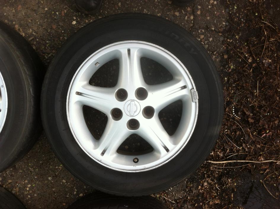

Hello everyone,
My Maxima got creamed and I'm left with the "summer rims."
Since they're now "homeless" rims, I'm thinking of using them for snow tires on my 06 Accord V6.
The Maxima rims are the 16" "star" pattern ones. The numbers all seem the same except for the center bore diameter. The center bore on the Accord is 64.1mm and the bore on the Maxima rims is 66.1mm.
Will this work?

Have you searched for a Hubcentric Adapter?
Also you can run them that with the larger hole cutout although many people will tell you that you should not.
Millions of cars drive around with the wheels centered by the lug nuts only.
