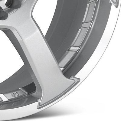

That refers to the shape of the outer lip of the rim. It doesn't affect the fitting of tires, but it DOES affect what kind of balance-weights can be used.
Clip-on weights (similar to what you'd use on a steel wheel) need a thinner lip, and some room to clip them on. If you get a "no-lip" wheel then you have to use glue-on weights. At least on the outboard lip of the wheel. With modern wheel-balancing equipment, shops should be able to use whichever kind of weight is required for the wheel.
Here's an example where there's no lip for clip-on weights. Compare against the inboard rim; pretty much all wheels can take clip-on weight on the inboard rim.
