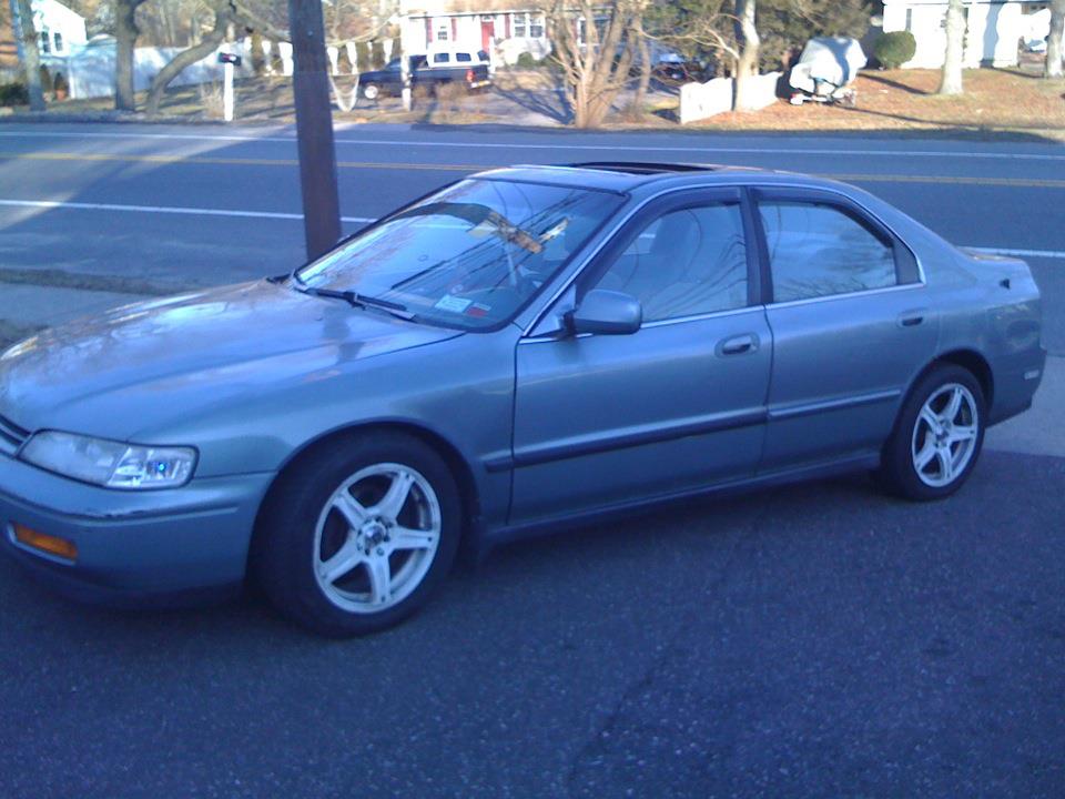

i need help if u hav a beater u should no hondas are known for there rust spots"cancer" annd being that i bought the car with it last year n let it sit through winter...it got bad.....so the thing is i dont wanna go to the paint shop cuz tht cost a grand and up so any ideas(plus i wanna make the top black,)?

start with a product like POR 15, simular products are available at most autoparts stores to kill the cancer. you will lose no more than you already have of the body, it will turn the rust black and then it's up to you whether to try your hand at bondo or patching panels. If you want to replace body panels, I have availabilty to fenders, bumpers, etc.. all CAPA approved, meaning they are all high quality replaccement peices.
