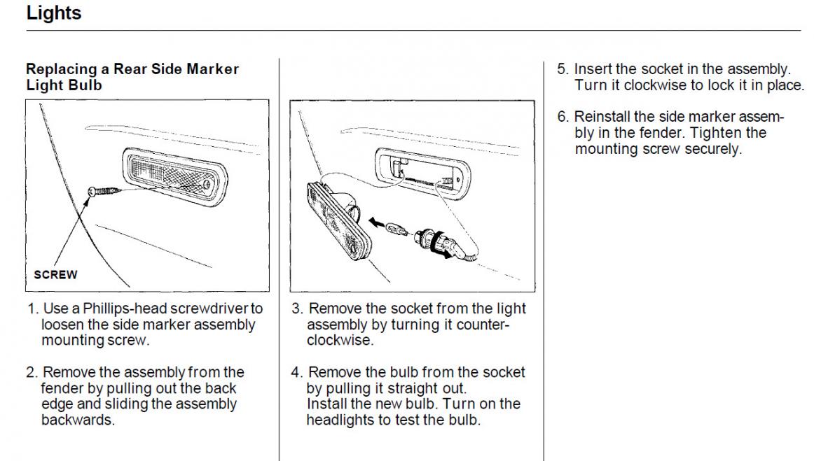

Old Jun 25, 2012 | 12:42 AM
The original rear side marker lenses were red with a clear bulb inside. The stock bulb light color without the lenses is a little yellowish.
If you use the same bulb in a clear side marker, then the lighting would be a little yellowish.
Since you mention an amber color, is the lenses the original red lenses or is it some aftermarket replacement?
