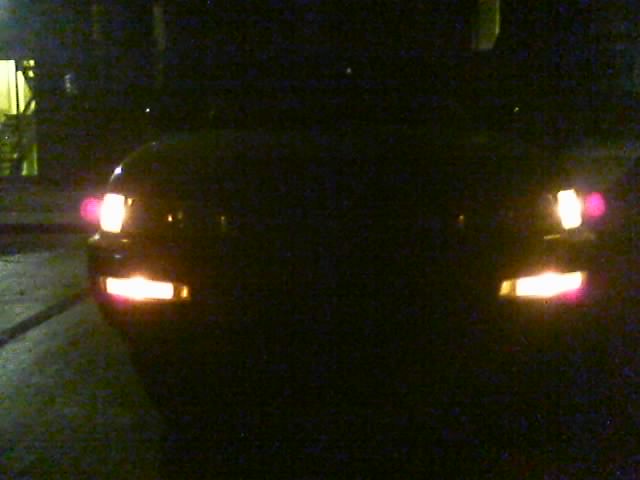

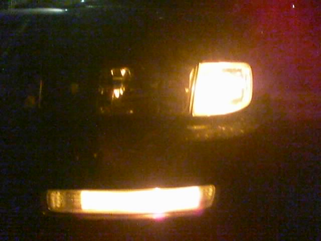

simple mod thatreally stands out. i havent seenany accord with the samemod. let me know what you guys think. lower blinkers still work.

Ive seen a few other Accords that have done the same on other forums. It looks good though!
How did you do it?

well my buddy owns a 91 talon and he did something like it and i was wondering if i could do something like it so i looked at his houseing on his lights and i found out that his light fixture is the same as mine. so i went to the local junk yard and found a dsm with the same parking light fixture and i sniped the wires and wired it up to my cars harness. see on the accord you olny have two wires comming out of the back of the light one for ground and one for the turn. well on the dsm fixture it has 3 wires comming out and so i ran the two orginal wires and the third wire is the constant power. so i taped in to the parking light above and ran the lower at the same time as the lower one. so i think it looks cool but it was kinda tricky to wire up and stuff but it worked it took me and my buddy like 2hrs to do. if your going to do it make sure you seal up all of your connections with heat shrink tubing to keep the weather out.

i heard that it can melt the plastic in the light housing. since its not ment to stay on constantly the heat melts the plastic. if this isnt happeningon urs let me know cause ive been wanting to do it on mine.

no its not happening to my car its all good plus i have the after market clear ones so it looks mint. ive have no prob with it melting. good luck with yours and let me see some pics after.
