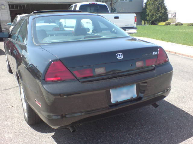

Is it bad to just use black paint instead of this night shade stuff? I mean th transparency won't bother me because I don't want to paint over everything. I want to try something like this image, but I'm not sure if I can just use paint or if I have to use the other thing.
Size:  51.5 KBI ended up doing it haha.

19Accord97
Default RE: Smoking/Tinting Tail Lights
Looks nice!
What was the process you used?

HustLa's Avatar
Joined: Nov 2007
Posts: 29
I removed the taillight. Used spray paint. 2 coats primer, 3 coats black paint, 2 coats of clear coat and let it dry about a day
Edit: I forgot to mention that I used clear red tape to put over the parts I didnt want painted and used a razor blade to shape it.

I was never a fan of the long red piece on the coupe. I like whta you did, looks MUCH better IMO. I'll be spraying my tails once I get them. I'm also going to replace pretty much all the bulbs. Going to go with LED bulbs where I can.
