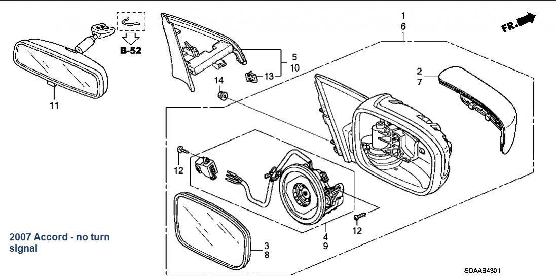

Sorry if this was posted in the wrong section but I was wondering if there is a package available for LED turn signal side mirrors.
I have a 07 Accord EXL V6 and would like to add this feature.

Is your car a coupe (2-door) or sedan (4-door)?
For sedan, people have used the side mirrors from the 2006 Accord hybrid, as the Accord hybrid had the turn signals.
For the coupe, people have used the Acura TSX side mirrors.
Both sedan and coupe involve some re-wiring. For the coupe, it also requires modifying the mirror bracket.

Yes I have the Sedan.
Do you know where I can find these? My car is graphite gray and would need it to match.
Old Jul 4, 2012 | 10:49 AM
Internet Honda dealers like Bernardi Honda Parts, Honda Parts Now, Majestic Honda, etc. have them at discounted prices for around $224 each side, plus shipping. You order them by the respective part numbers for the color code.
Right now, I haven't found how-to do the wiring hook-ups that will be needed to get the turn signals functional though.
