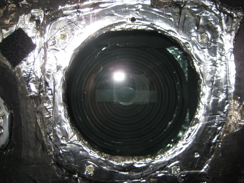

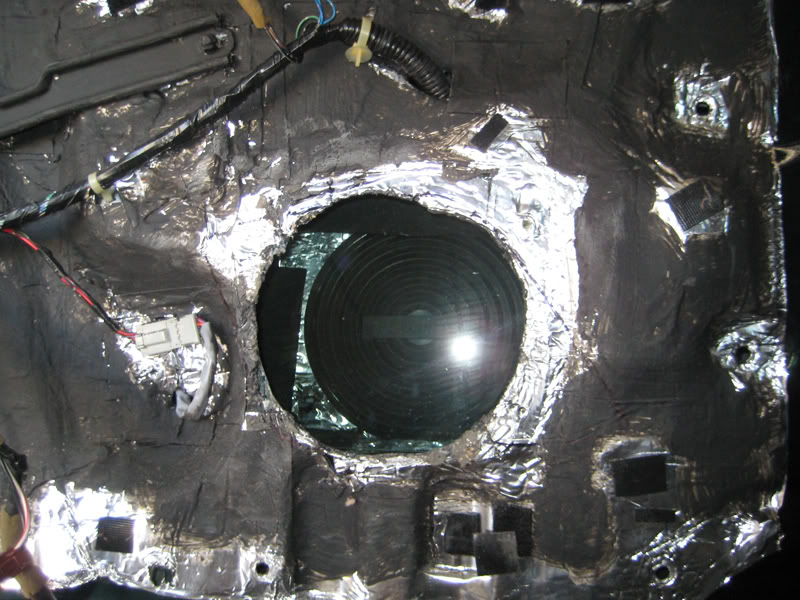

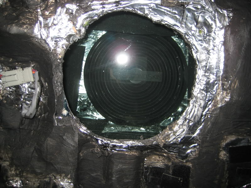

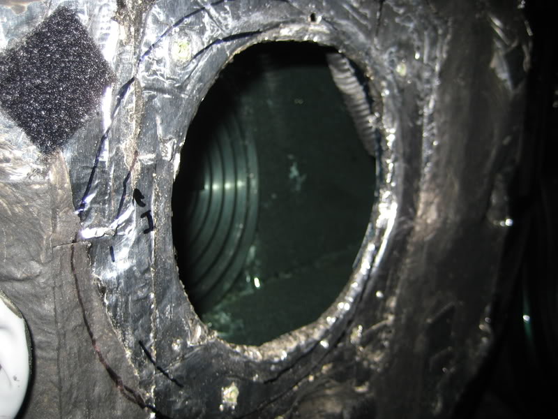

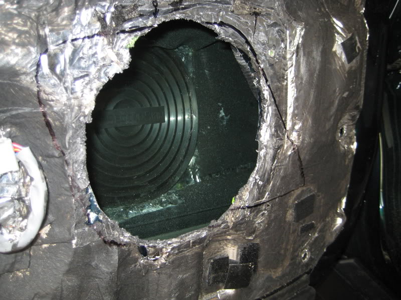

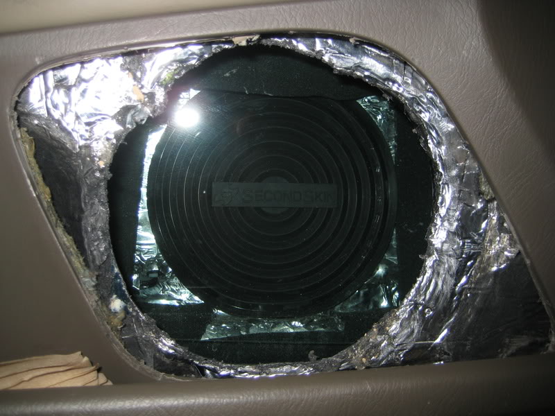

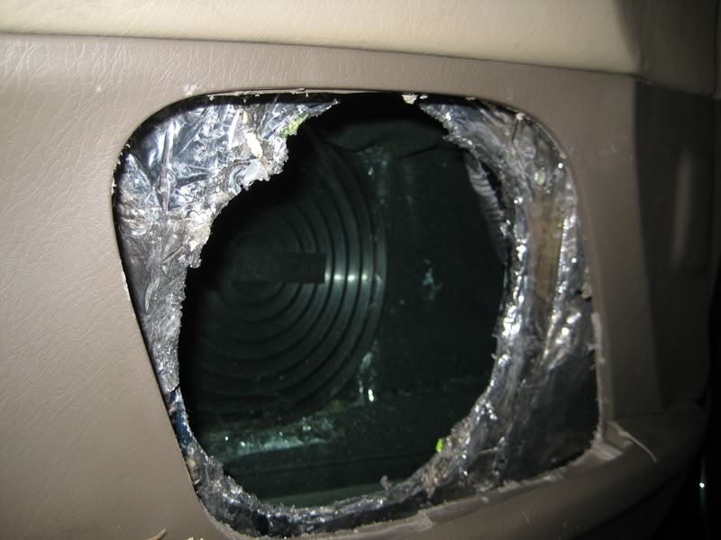

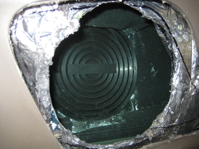

I got around to cutting the doors. I only did the driver door since I want to make sure everything works just fine and then I'll move to the passenger door. I accidentally messed up by cutting the size of the speaker instead of the cutout diameter. It's not too big of a deal, just need to make the baffle a little bigger and cut more of the door panel, maybe by half an inch each side.

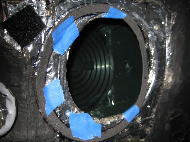

With the door panel I placed the thin foam gasket that came with the mids where I would want the mid to be so that it would fit well in the area I need it to be.
Took the door panel off and marked with a Sharpie where I need to cut.

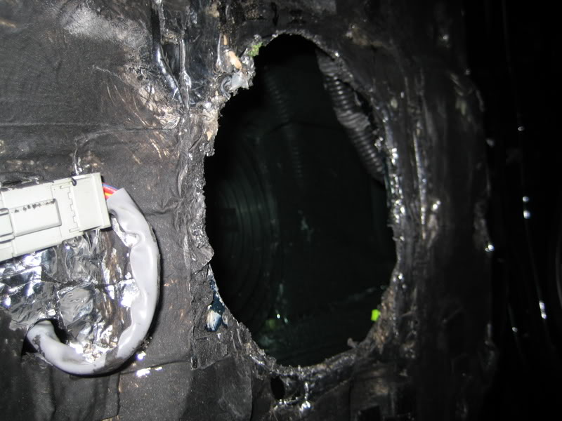

Did the actual cut with a jigsaw. It was very easy and I found it to cut in a circle by itself somehow. I was hardly turning the jigsaw itself
I started using some sheet metal cutters at first but felt it would take too long and the jigsaw was a good idea. The little piece in the upper left corner sticking out has been removed, just not pictured.

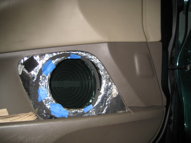

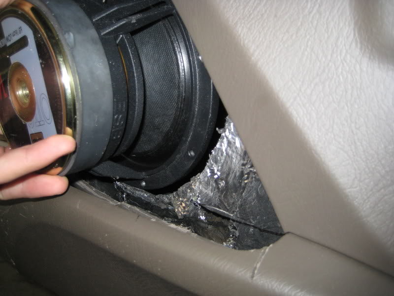

Put the door panel back on to see if I needed to make any adjustments, but it seems it turned out quite well.

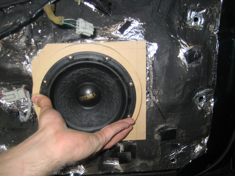

Got my Sharpie out again and traced where the door panel was so that I know how to cut my baffles without them touching the door panel itself.
Reason I did that is because I will be using 1" baffles which will more than likely work. If not, 1.25" baffles will definitely work. As you can see I have a little under 3/4" of space from the door to the door panel, so anything larger than that, the baffles will not allow the door to remain in place via the clips.

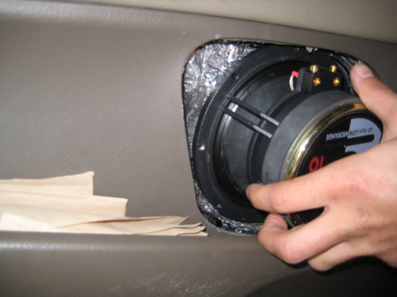

Tested to see how the mid would with the door panel on. I inverted it to see better and get a better idea since as I mentioned, if the baffles are in place, the door panel will be sticking out. Everything seems to be going well.
Tomorrow I will be cutting the door panel a little and start on the baffles. I plan to trace the stock speaker grill so I have a general idea what the maximum size and shape the baffle should be within.

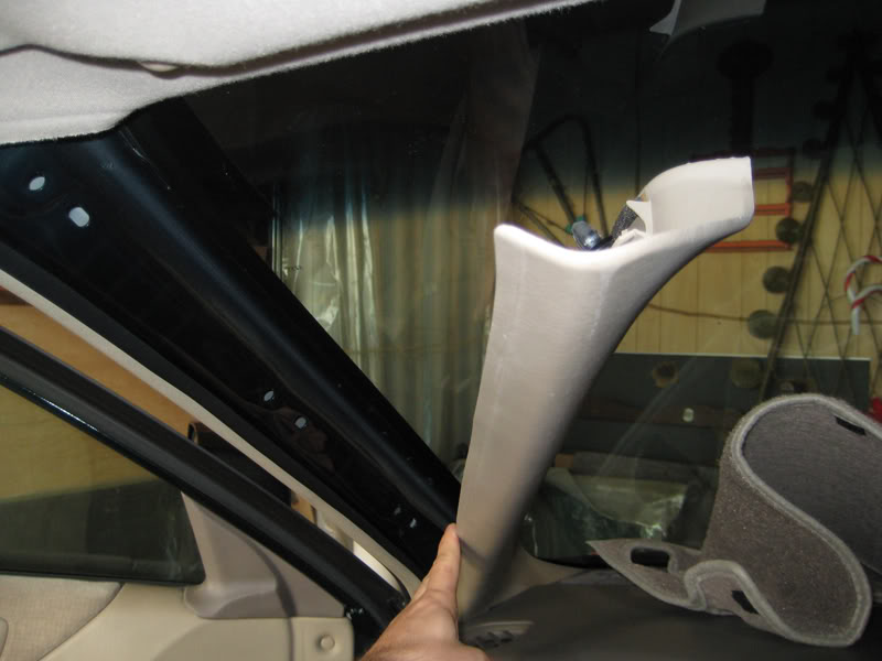

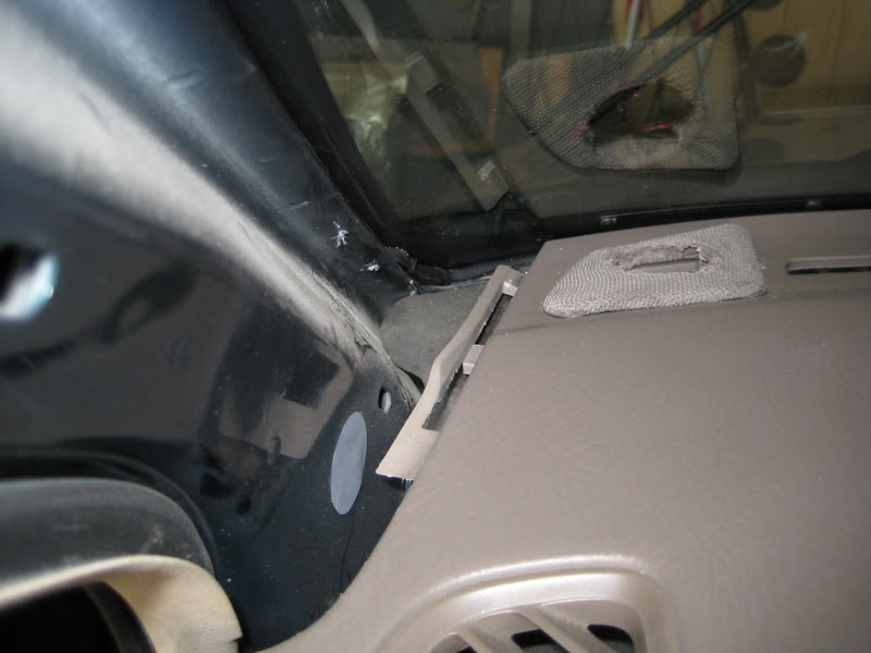

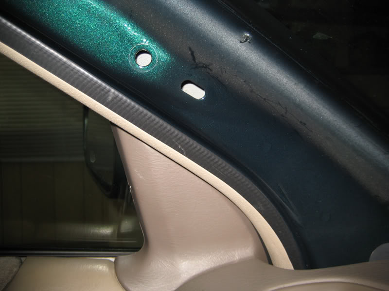

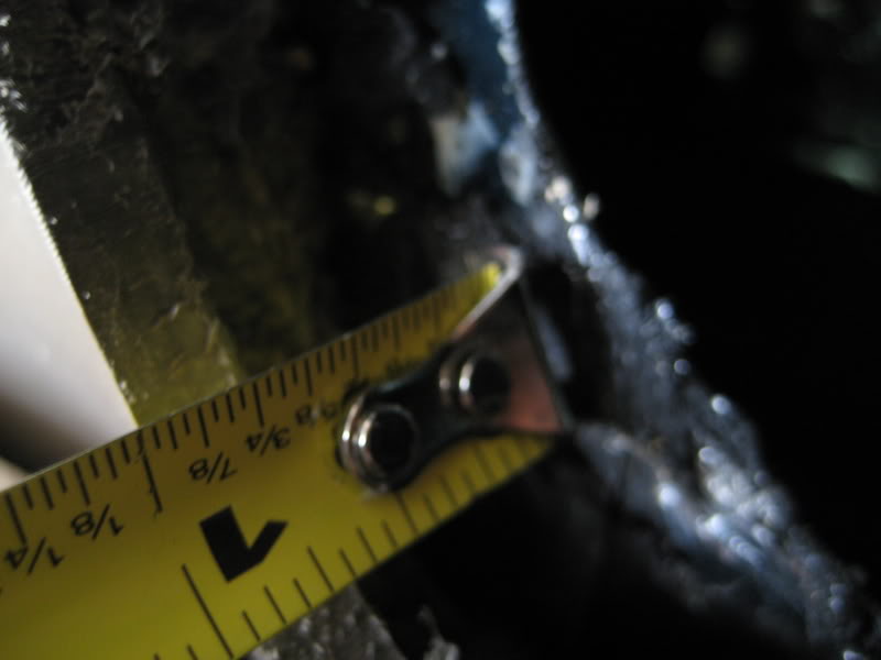

Didn't do any baffle work today since I was waiting on a call for something, and won't be able to tomorrow. Might be able to on Thursday or Friday. I did check some things out though. My stock locations for the tweeters are up on the dash by the windshield. I was getting reflections off glass to the dash and it messed with the imaging so I got a dash mat. I am going to end up doing the tweeters in the A Pillars.
They were quite easy to take off (thank goodness). Here is a picture of it nearly taken off.

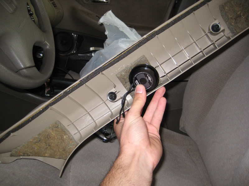

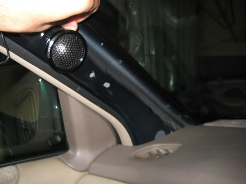

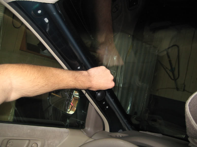

A shot of where the wires will come, which will be on the left side by the A Pillar. You can also see where the tweeters were originally mounted. I will either use my 2nd dash mat since it doesn't have the openings for tweeters or I will cover them with speaker grill cloth I just bought.

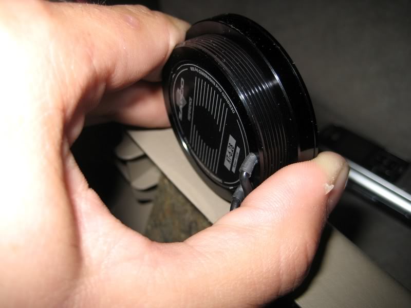

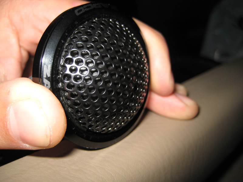

Reverse side of the A pillar panel and where the tweeter will be mounted.

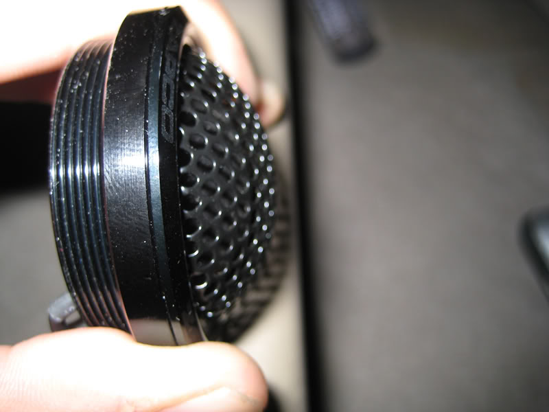

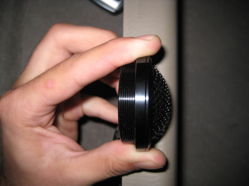

I have plenty of room thanks to the short mounting depth of the Zapco tweeters. It doesn't look like there is in the pictures, but visible to the human eye there is plenty of room.
General location of where the tweeter will go.

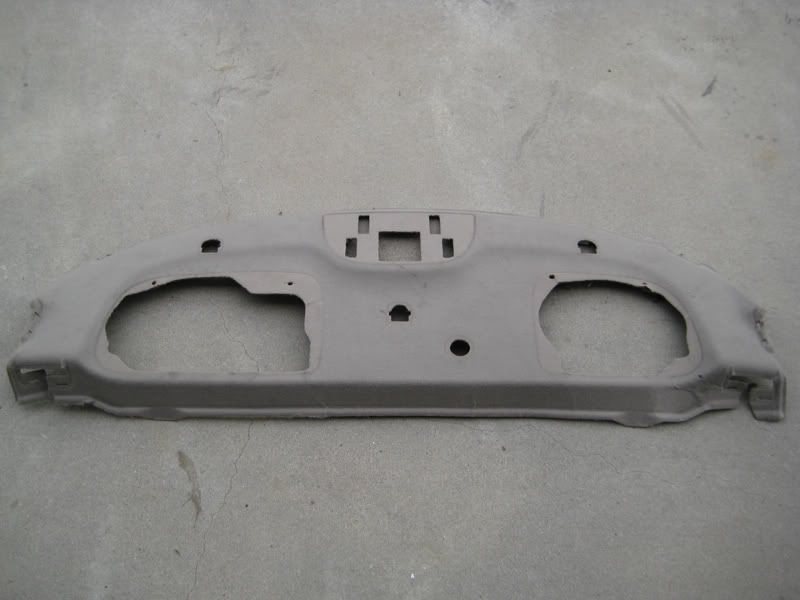

As I just mentioned, I bought some speaker grill cloth. Part of it will be for the lower portion of the door panel and another part will be for the rear deck cover. The only holes that will remain uncovered will be the furthest left and right one on the top (or rear) and the two small ones in the center bottom (or front). Everything else will be covered.

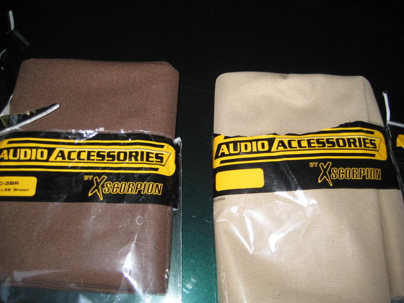

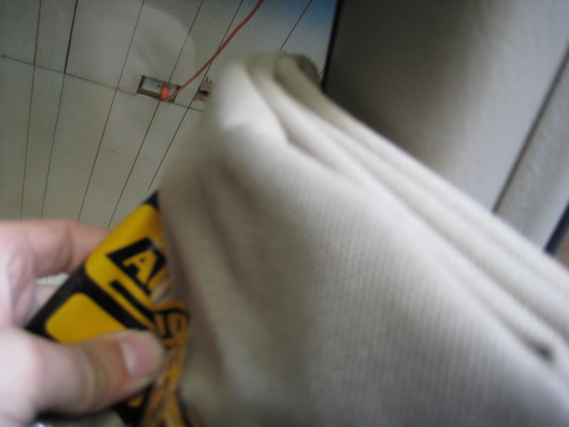

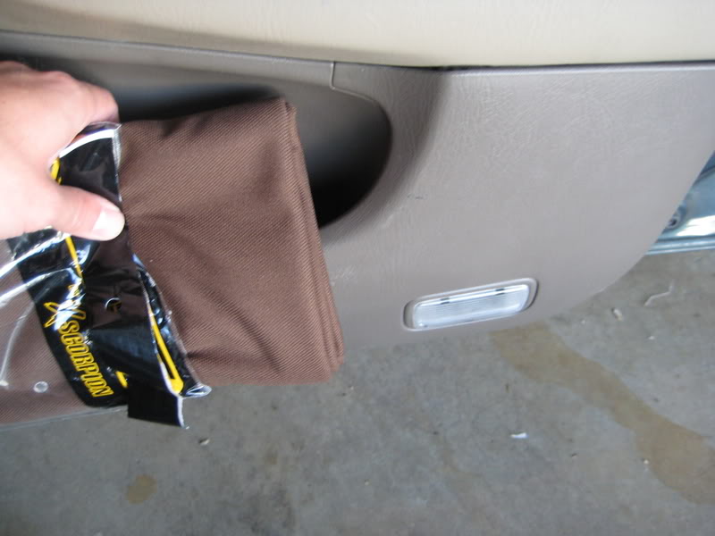

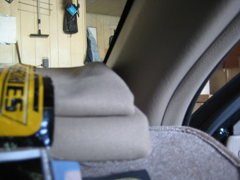

Got the speaker grille cloth for the doors, a pillar and rear deck. The one on the right I got two of for the rear deck and the a pillars, the one on the right for the lower portion of the door panel and even the triangle piece on the door.
The light color is VERY similar to the stock color, good choice

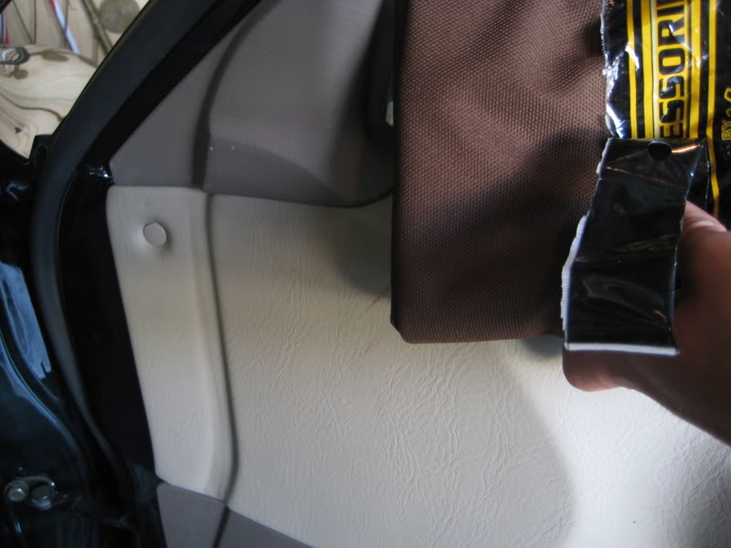

The brown is a bit darker, but it still will look pretty good. You can see the triangle piece in this photo I mentioned earlier. I'll probably cover that so the door doesn't look awkward.

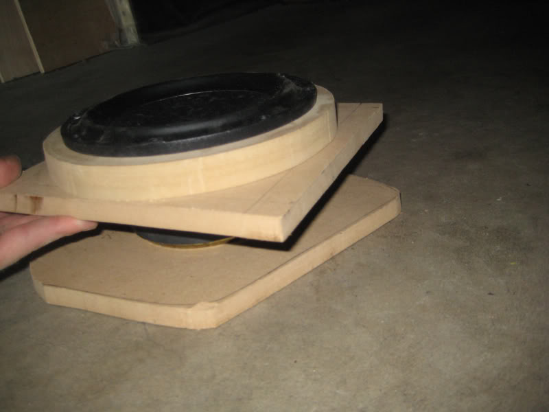

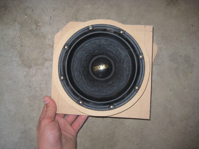

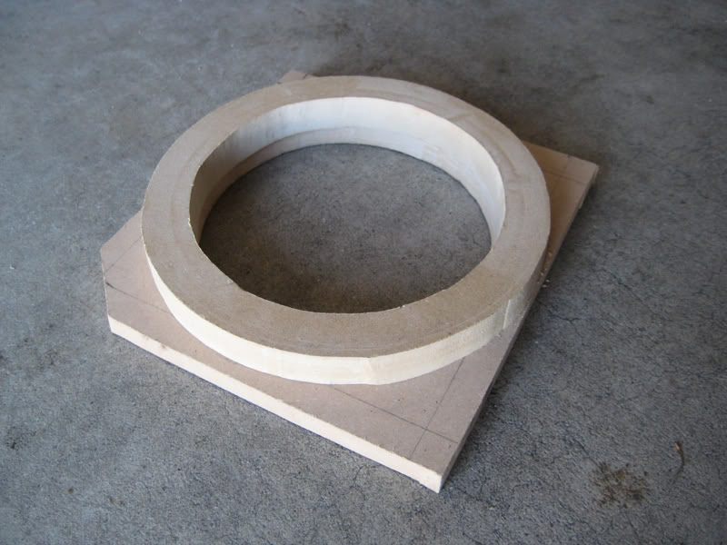

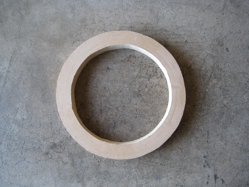

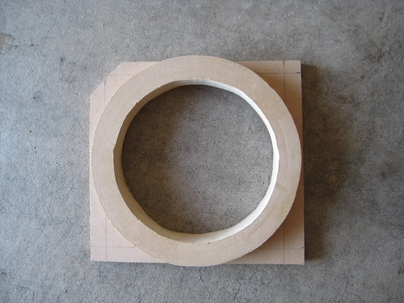

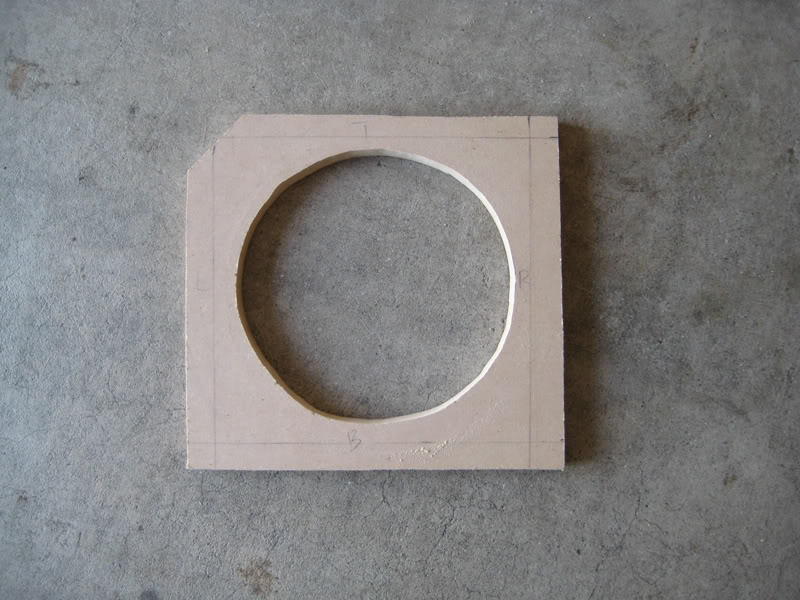

Got done with one baffle, it should work. I decided that the easiest way to do it would be a square, only thing is there is a little hump as you can see.
I cut out a square, rectangle actually, 8" x 7.5" and cut off one of the corners
I was going to use another 1/2" baffle, but I figured I'll be safe and do 3/4". I used the cover for the gallon of spectrum I have, traced it, and cut it. Then I cut out a mounting hole using a previous baffle.
Test fits:
Fits fine in the door

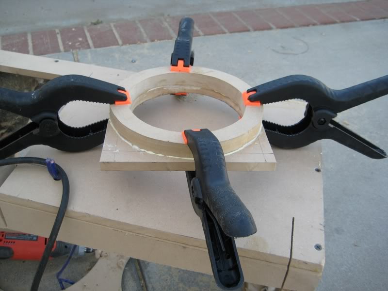

Glued last night and its ready. Figured I wouldn't use screws so it won't split it and so I don't have to worry about some screws hitting others.
I'll do the other one this weekend.
Test fits:

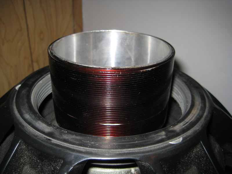

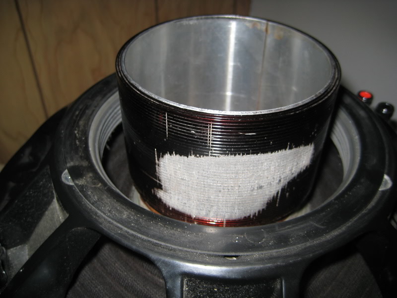

I just decided that I’m not going to use the 18†5200. I have to make a few calls and send out a few emails to figure out what I’ll get. Reason why I have the sudden change in mind is because one of the tinsel leads came off from the spider and a couple are loose. Also, this somehow happened to the coil.
The driver still works just fine and I’ve been playing it like this for quite some time. I noticed this several months back when I was building a new enclosure for it. I’m going to get it reconed, but I have to see if whoever does the recone can make it similar to what it is. Basically I’ll need something that is a QVC that is 1.4 ohms or higher, though 2 or 4 would be preferred since I’m running the PDX, must be able to be used in 3.5 cubes sealed. I’ll have them use different tinsel leads and maybe use a paper cone. Whatever I can do to make the sub more efficient and still work with what I need, I’ll do it.
In the mean time, I’ll probably take out my 18 for now and have some fun with 15†LMS 4000 that I was using for HT (5 cubes with 1k for HT is not near enough what the sub needs I guess). I’ll see how it does off 1,000w in my car. Worst comes to worst I’ll seal the 15†hole and see what three or four 8†eD EHQS subs will do.

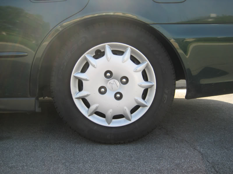

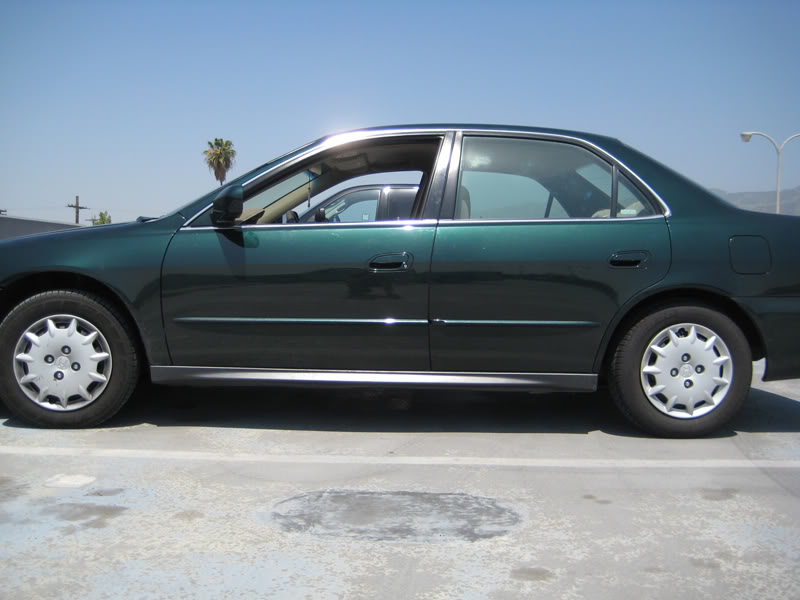

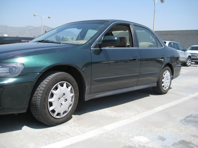

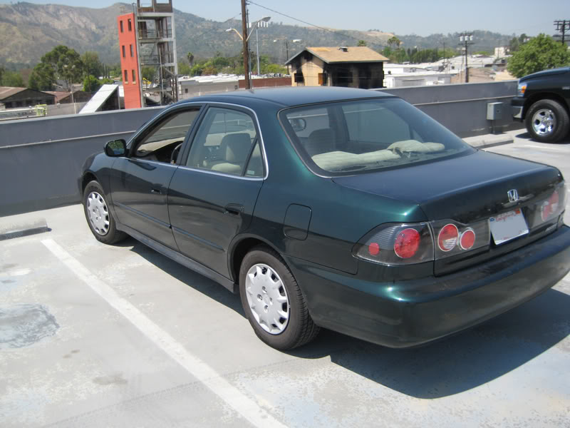

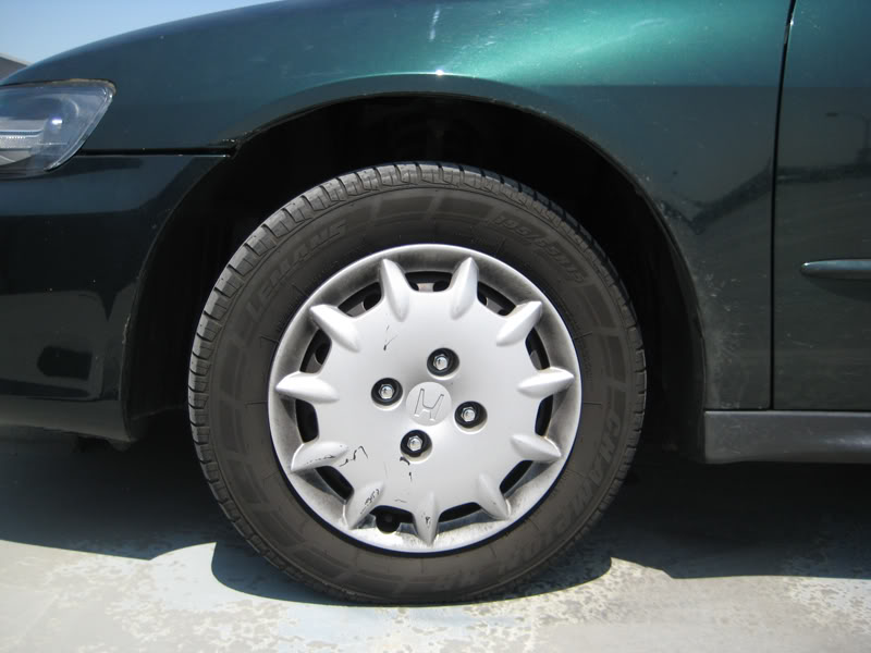

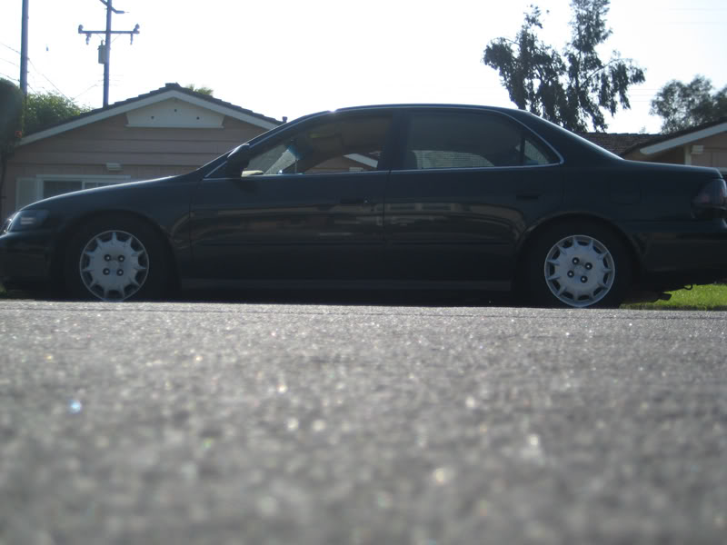

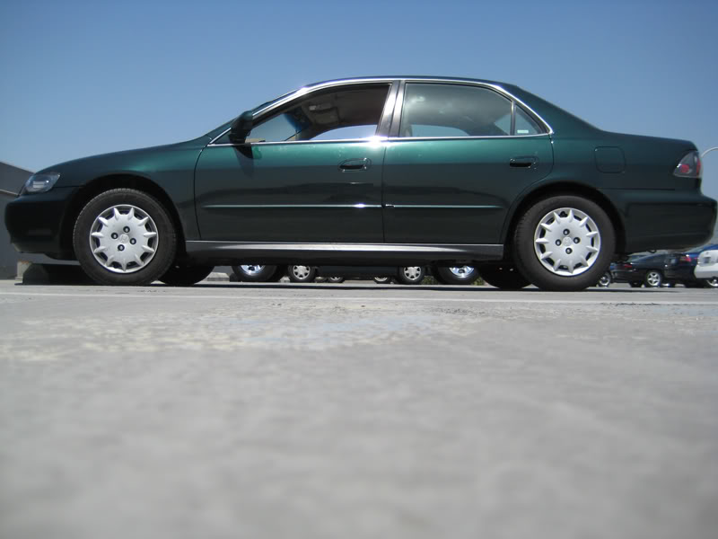

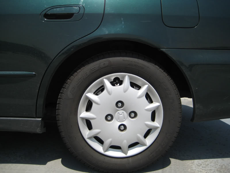

My shocks seemed to have been giving out, at least they made squeaking noises time to time. Plus I had the whole boat ride going on so I bought a Megan Racing coil over damper suspension kit. The strut bar is also from Megan Racing and they didn't have the gun metal but had red so I was gonna go with that, but it turned out it was broken so I get the gun metal in about a week. My alignment was a bit off before and i can tell a big difference now, but it's still drivable and will get fixed next week as well.
I dropped it about 2.5" and it rides nicely and handling has GREATLY improved. Anyhow, here are before and after pictures.
