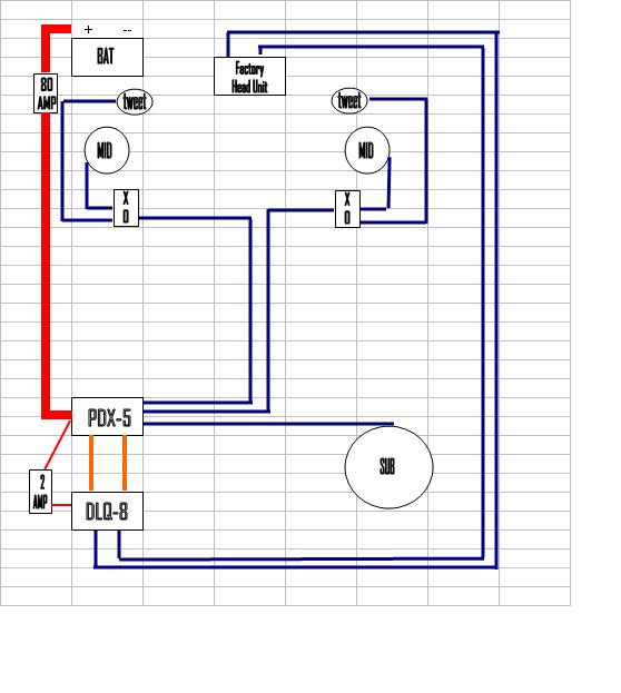

Well I decided to do without the rears and place a sub in the right rear corner. I picked up a Audiocontrol DLQ-8 and Focal 165A1 for the fronts. I have attached a diagram of how I think everything should be wired up. Is this right? Are the fuses ok for the system? The red will be 4awg and the blue are 16awg twisted speakers wires.

keep_hope_alive's Avatar
Joined: Dec 2009
Posts: 3,279
From: Quad Cities, IL
Looks good.
