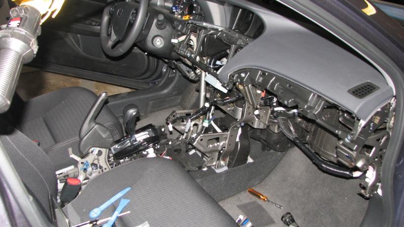

actually, Honda and Toyota make some of the easiest cars to disassemble. i've been doing automotive installs and work for the past 20 years and the newer Honda's are the easiest. the rear deck does require some time, but it's just one piece at a time. i could disassemble my 2001 Accord with ease - in 45 minutes the entire interior (seats, console, trim, carpet) could be removed. dash came apart easily:
this was installing mass loaded vinyl down under the carpet:
i've had my 2014 Accord apart several times and reassembled without any incident. below is an pic i took while customizing the dash in my 2014 Sport:

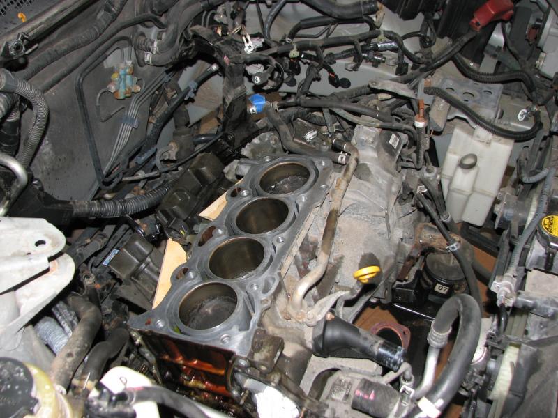

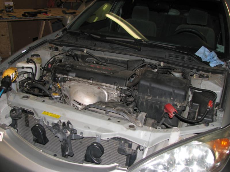

part of what makes them (Honda and Toyota) easy to work on is the use of high quality clips and parts. last fall, i re-tapped the cylinder head bolt holes (installed TimeSerts the engine block) in my 2002 Camry - in a weekend. not a single bolt was a problem.
during
after

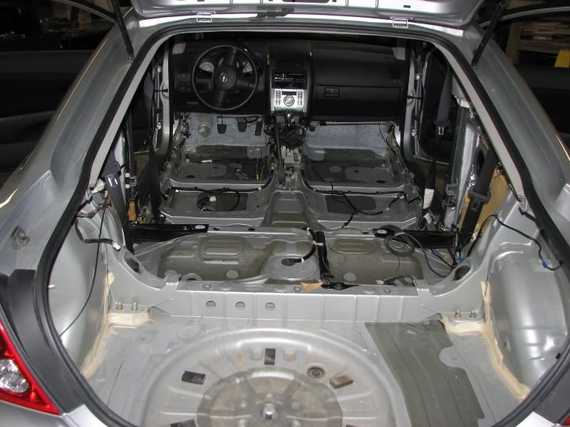

here is a 2005 Scion tC emptied:
i only show you those pictures to give you hope - to let you know that these cars are a joy to work on.
