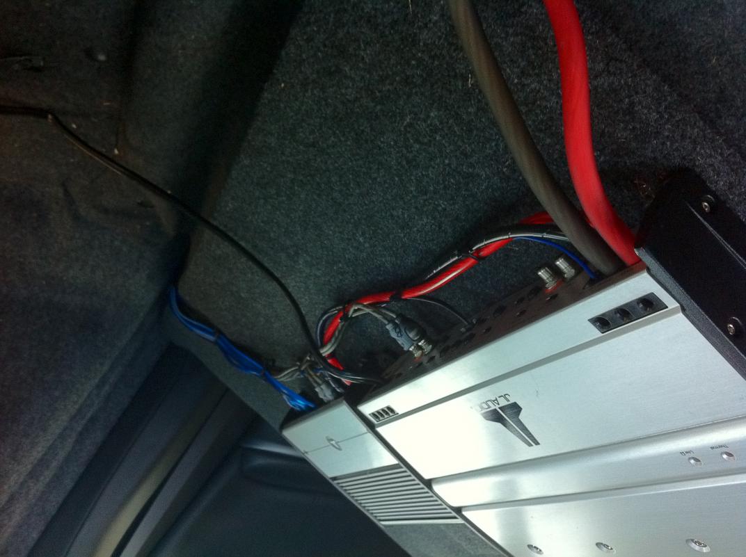

Also - look how he installed the amps power - any issues there? There is a 100A fuse by the battery, but shouldn't they have used a distribution block instead with fuses for each amp? Could this cause the issue?

his power wiring is technically ok if the smaller amp has it's own built-in fuses. if not, then his tap is a fire hazard.
I don't see fuses. that 8 awg wire is not protected for over current. the amp is not protected either. that violates the manufacturer's warranty.
http://mobile.jlaudio.com/pdfs/18703.pdf
Page 5 of the owner's manual requires a 40A fuse at the battery when a larger wire is used to power multiple amps. i would require they fuse that amp feed because without it, your mfr warranty could be denied by JL.
how did they get a signal to the amp? did they use high-level inputs on the JL with auto-sensing turned on?
i think your noise problem is grounding. take a pic of the amp grounds. i recommend you re-do those with a bolt through the floor, #1. next, upgrade the Big 3.

they could use a
Stinger SFB1MAXPT Car Audio MAXI Inline Fuse Holder
in lieu of a distribution block - provided the power wire into the large amp isn't compromised. A fused distro block is certainly preferred.
