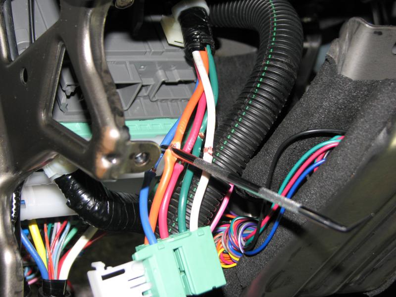

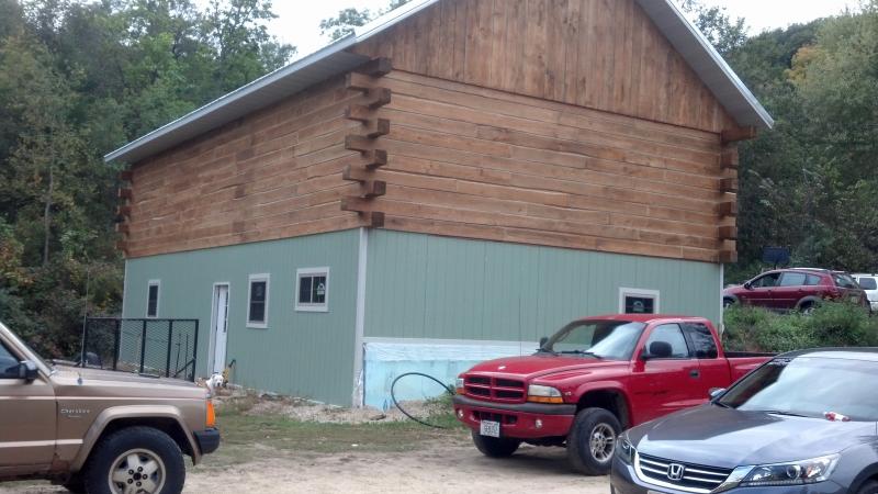

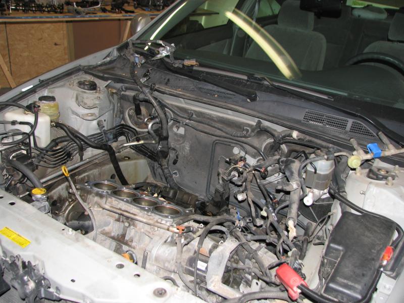

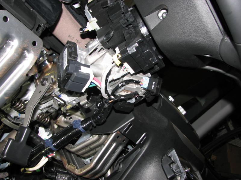

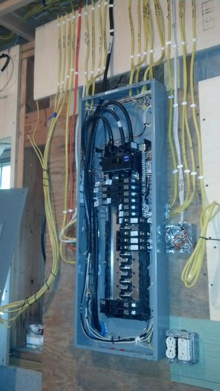

no. the past month has gone as follows:
wedding in northwoods WI (5 days eaten up)
wiring a new log home in WI for two consecutive three-day weekends.
install Viper remote start on my Accord
and this past weekend i tore my 2002 Camry apart to install time-sert in the block for the head bolts
Attached Thumbnails Honda Electrical Load Detection (ELD) Bypass-img_20141005_142151_446.jpg   Honda Electrical Load Detection (ELD) Bypass-img_20141013_115002_990.jpg   Honda Electrical Load Detection (ELD) Bypass-alarmrs2014008.jpg   Honda Electrical Load Detection (ELD) Bypass-alarmrs2014015.jpg   Honda Electrical Load Detection (ELD) Bypass-img_7710.jpg

Looks good, nice work.
