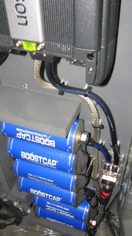

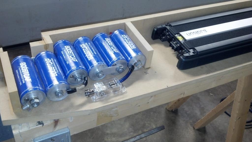

I have an ultra cap bank good for 500F at 16V. It's six BCAP3000 wired in series (3,000F each at 2.7V). the ultracap bank does certainly help with regulation.
i tie the cap bank into a fused distro block. the fuse is important because you need to disconnect the cap bank BEFORE disconnecting the battery and reconnect AFTER reconnecting the battery. the caps alone can allow you to start the car. they need to be charged slowly, so the fuse can be replaced with a resistor bank (i use a pair of 15ohm 25W in parallel) for slow charging.
