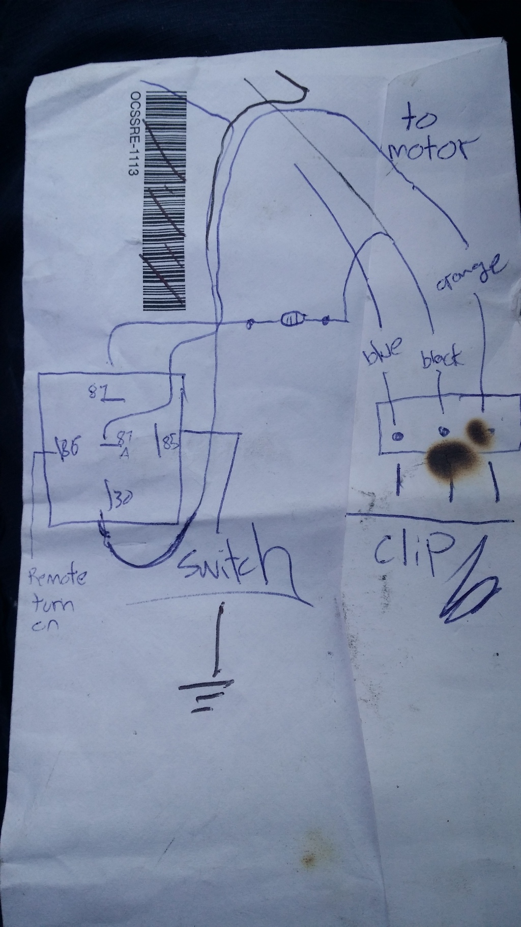

This is my plug is under my fuse box. And this is the schematic I did. Blue/silver on the left, black in the middle and orange/silver.

your drawing looks fine.
the remote turn-on should be the same for both amps.
pics of the amp wiring?

Yes both amps share the remote wire. I believe I have to add a relay to the remote wire for the amps and n other accessories. I also only put a 815 ohm resistors. how do I determine the resistor value? I have a multi meter but how do I do the math part???
with the resistor in place, if the DC voltage seen by the PCM is around 2VDC then the resistor value is sufficient.
the amp problem should be separate from the ELD concern.

Problem has been fixed. I added a relay for the extra amperage for the extra accessories I have since the radio can only remote turn on a limited of things with out the relay. I still wanna know how u determine the resistor value.

i just measured voltage at and across the ELD with accessories turned on. then ohm's law tells me current and thus the resistance.
