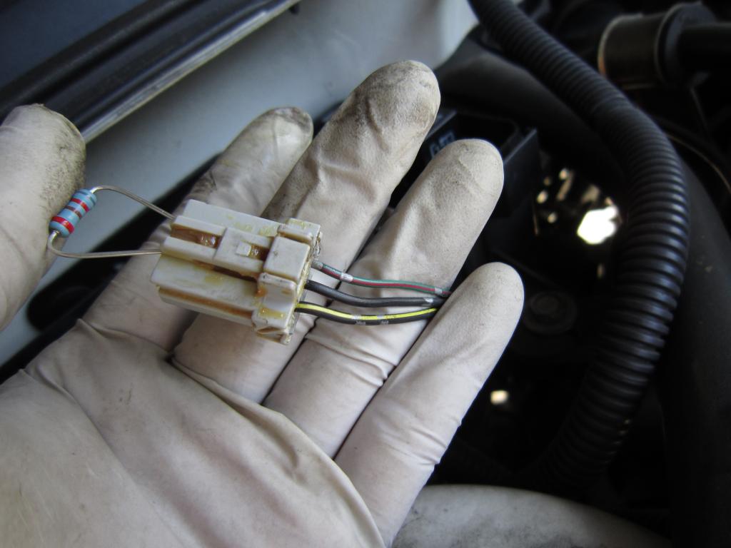

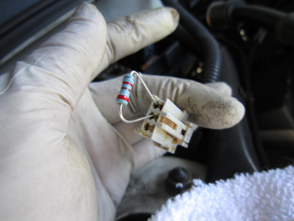

Old Nov 8, 2013 | 11:51 PM
  #76
949's Avatar
949
Joined: Nov 2013
Posts: 15
Attached Thumbnails Honda Electrical Load Detection (ELD) Bypass-img_4794.jpg   Honda Electrical Load Detection (ELD) Bypass-img_4793.jpg

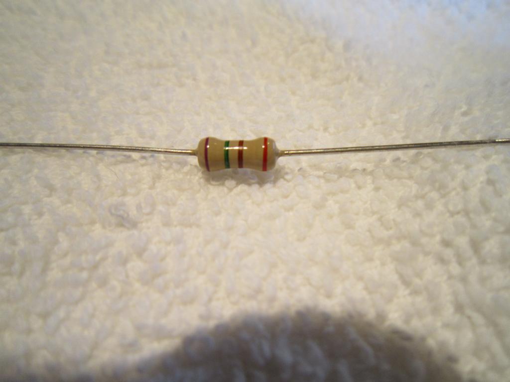

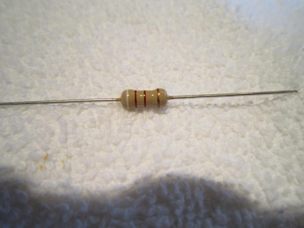

well, I decided to go out and buy another set of resistors to see if I can raise my volt range.
resistor #2
band color:
white / brown / brown / gold
920 ohms 5% tolerance
resistor #3
color band:
violet / green / brown / red
750 ohms 2% tolerance

that's not how it works - the resistor value doesn't determine the actual voltage - it just tells the PCM to turn on the alternator field current.
actual voltage measured depends on several factors, including where the voltage is being measured, the voltage drop on that wire, and the electrical load on the car.

changing resistor value changes the voltage the PCM sees. at some point, that hits the threshold of turning the alt on vs. off.
