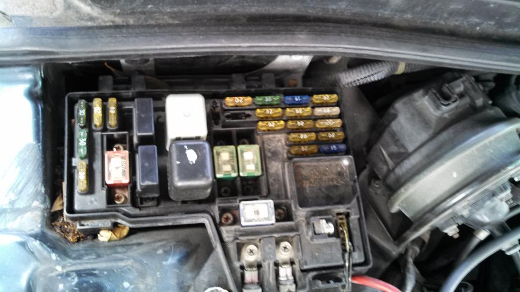

Im having electrical problems when running lights and a/c. I had a buddy scan it 12.75v was average and hit bottom around 10v. We checked alt. and battery both showing 14.09v. He was saying the ecm wasnt grounded to motor when it was replaced. Could it be no grounds on motor and eld or both?
Btw I gotta 97 accord lx 4 banger.......Oh yeah wheres the eld located?
I also forgot to mention my thottle cuts out when running a/c and lights. Everything checked good on scan except voltage
Attached Thumbnails Honda Electrical Load Detection (ELD) Bypass-img_20130630_161206_730.jpg

the small wires in the bottom right are the ELD wires. the ELD is under the fuse box.
motor grounding is paramount. upgrade engine block to chassis ground.
