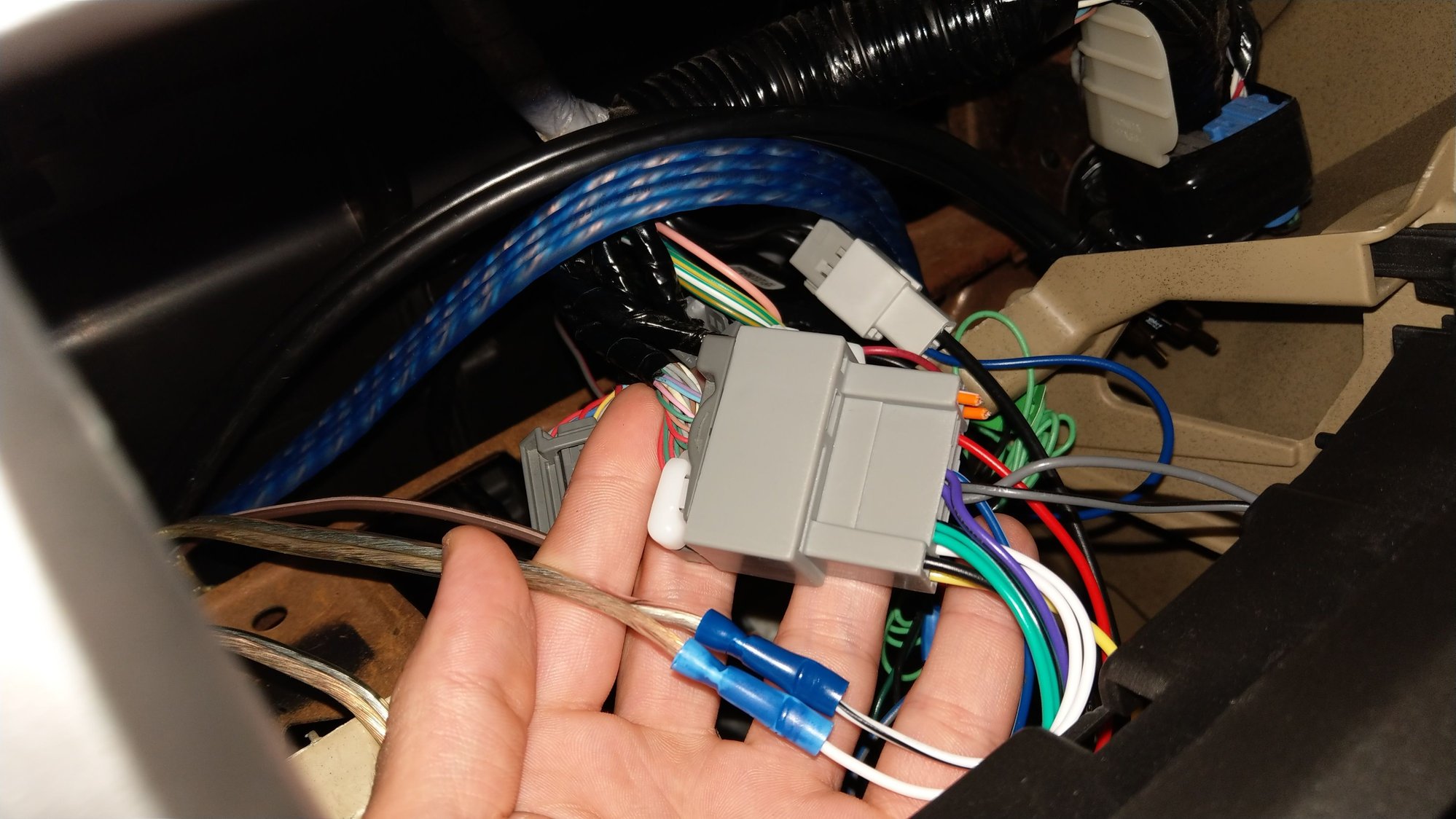

your picture shows three pairs of RCAs into the amp. I assume those are front/rear/sub RCA outputs from the head unit. These RCA cables feed the signal into the amplifier. The speaker outputs on the head unit are not to be used.
I suspect you have paralleled the aftermarket amplifier speaker output and the head unit speaker output which is why there is a problem.
in this picture, the aftermarket amp speaker wires are not connected to the harness, just the head unit speaker outputs. where did you land the amplifier output wires and what did you do with the head unit wires?

yes, I do have 3 pair of RCA for front/rear/sub
Blue ones - front and rear
Black ones - sub
I believe I plugged them in properly but the picture will say that
this is how I did them. if needed, let me know what picture and I will go and take it to provide whatever is needed for fixing the issue.
on the last picture here you can see how the blue wires went lose and went out - not a good connection.
- suggestion for a better connection
- could this be the problem for all this?
please check this
because this is very wierd. no idea why it's happening.

I think you need to cut the 8 speaker wire outputs from the head unit (tape them up separately). Those 8 wires shouldn't be connected to anything, and I suspect you have your head unit output and the aftermarket amplifier output both connected to the front speakers; which will cause your issue. The front speakers should be directly wired to the aftermarket amp with no other connections to other wires made.
Loose connections are always a concern, you shouldn't be able to pull any connection apart with light-to-moderate effort. Those crimp connectors aren't the best option, even though they are popular. I have a YouTube video describing wiring connections.
A photo of where the speaker wires from the amp connect to the wires in the car would be helpful.

this is a picture of how I connected front speakers to amp. I was trying to save myself disassembling the door and wiring because I can't find a good guide for coupes. everything is for sedans. also, that's how I did it on my 2000 Accord Coupe but the issue maybe comes from 2000 Accord doesn't have factory sub with factory amp and the 2012 has. let me knwo if I am on the right direction and what to do. if you have guides for wiring front speakers please share. thanks
