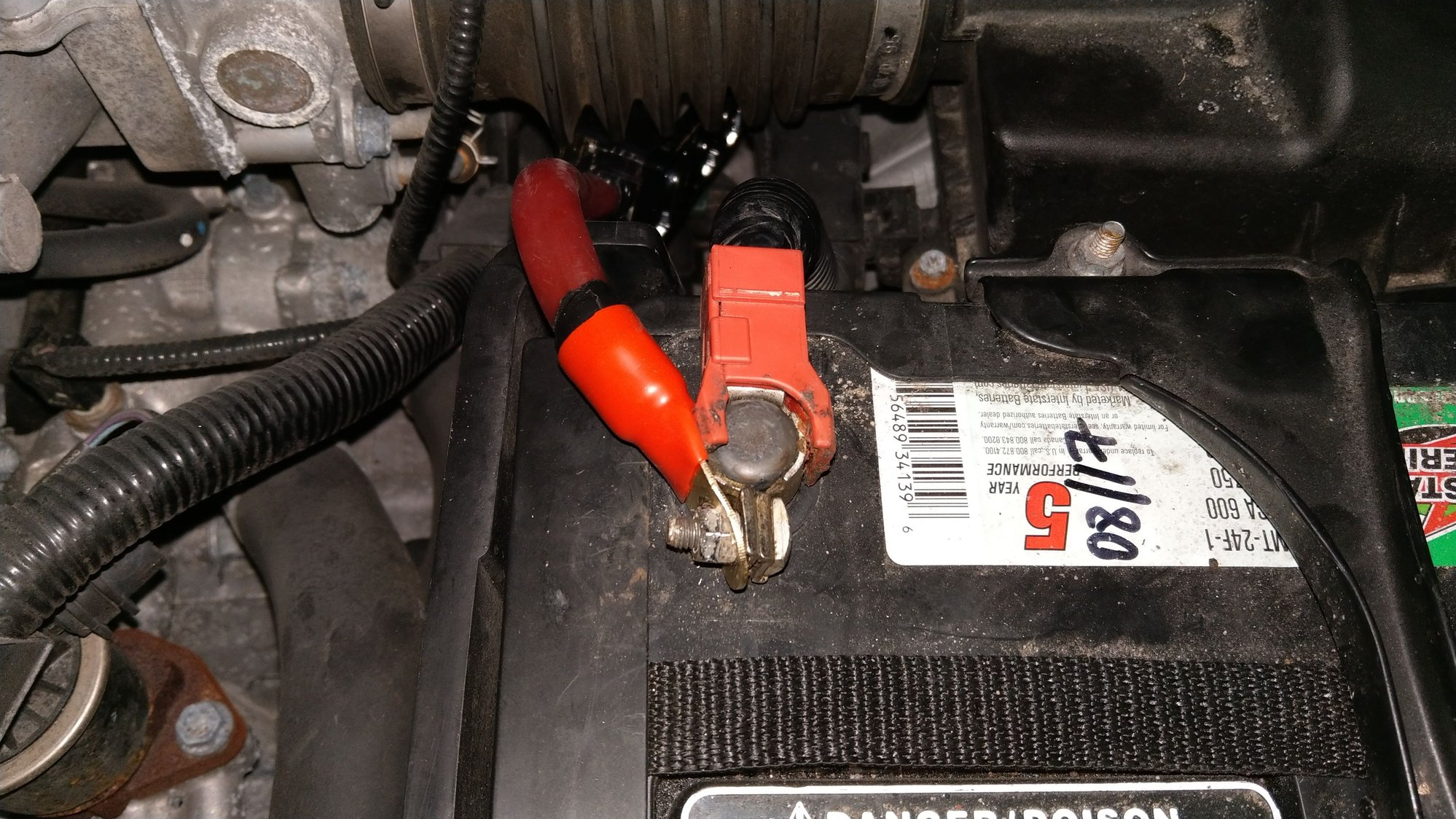

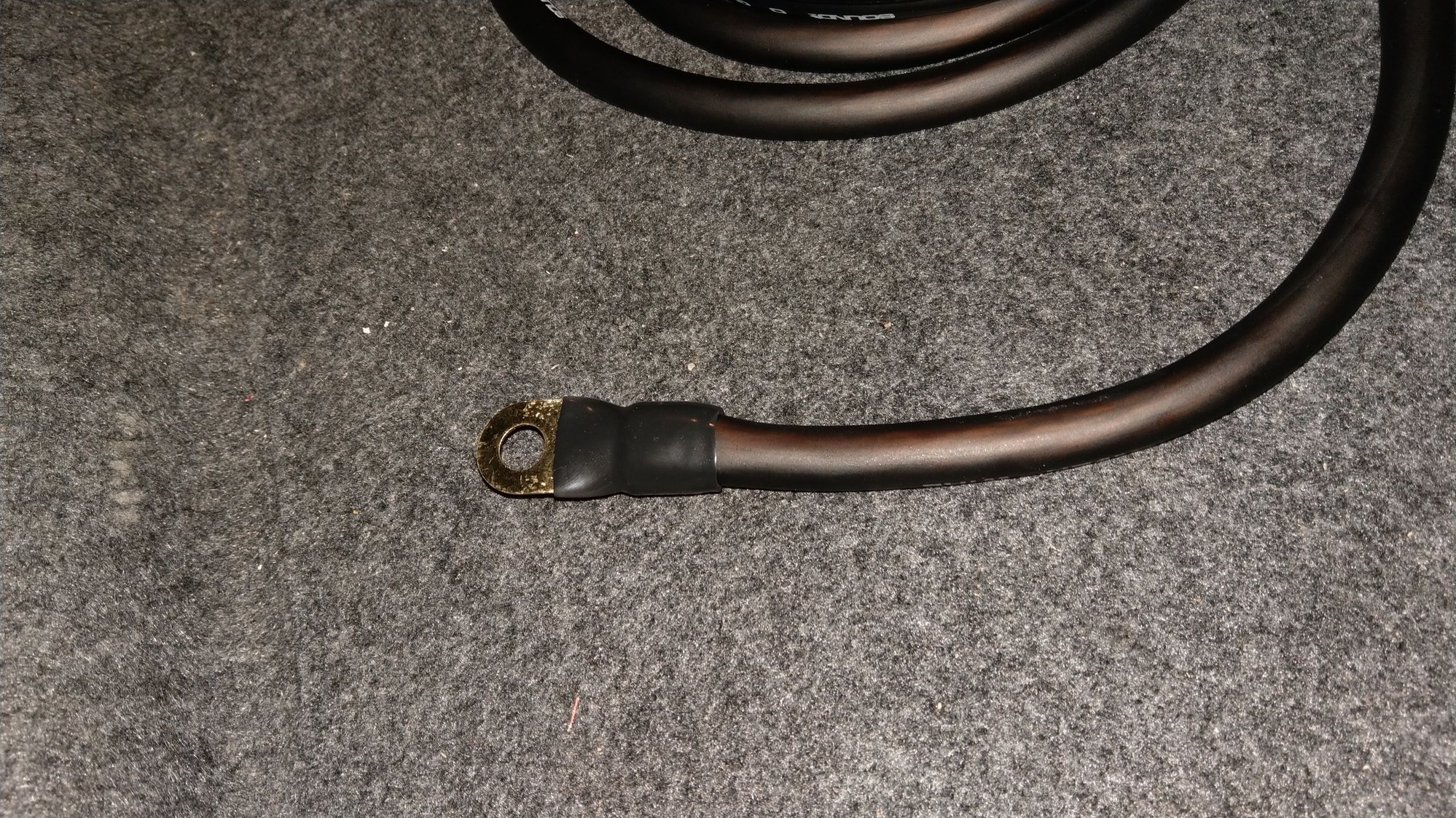

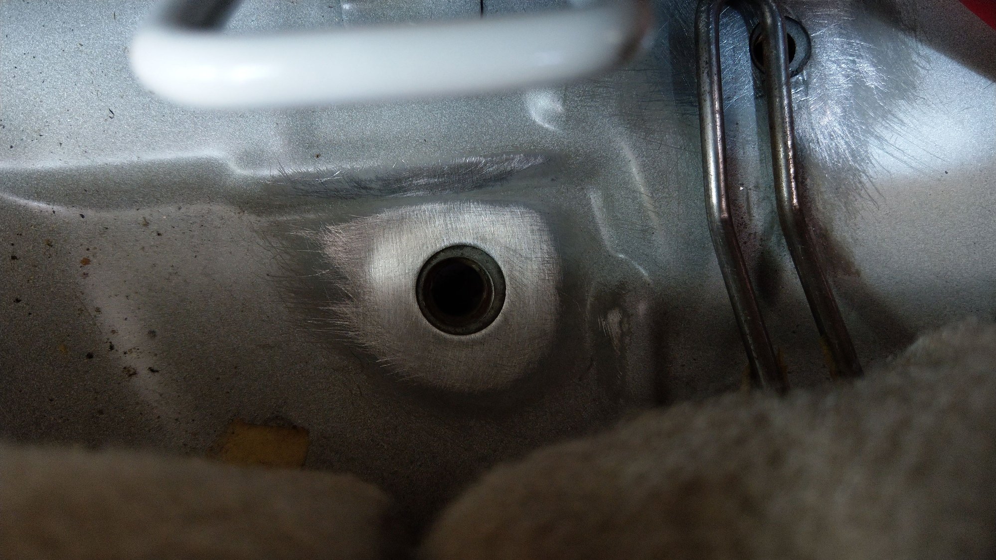

Hello everyone,
2012 Honda Accord Coupe V6
I installed new radio, rear speakers, box with 2 subs and amp. 0 Gauge cables for positive and negative. After everything is attached there is a huge static. Here are pictures of what I did and I'll post 2 videos. Please help me out. Trying to figure it out for a week
Thanks in advance.

Is that the poorer cable running with all the other cables. It should have been ran separately. I sounds you are having an emi issue

It was suppose to be power cable. I am referring to the cable running to the trunk

You always run your power cable separately to avoid emi or get better speaker cables. You might have a few things wrong with the install but I can't make it out with the pics
