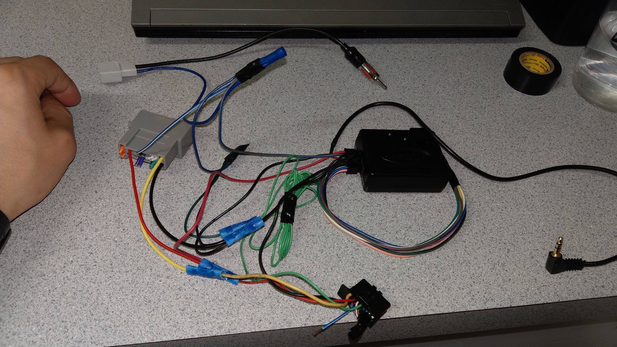

on the very right side is ASWC-1, on the down side of picture is Pioneer Radio Harness, on very left silver harness is the aftermarket bypass, very top is antenna

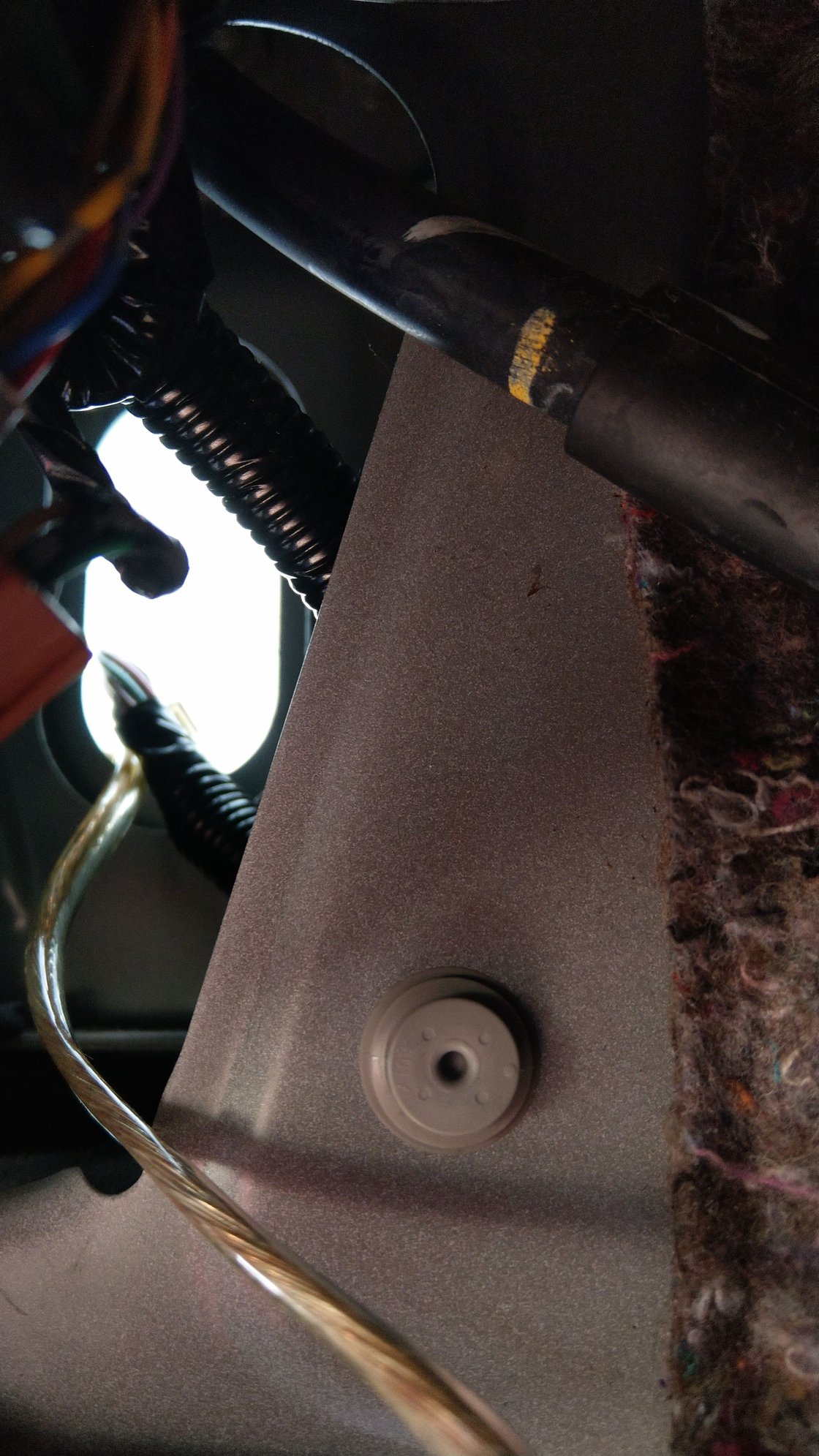

right side of the car how I passed the speaker wire

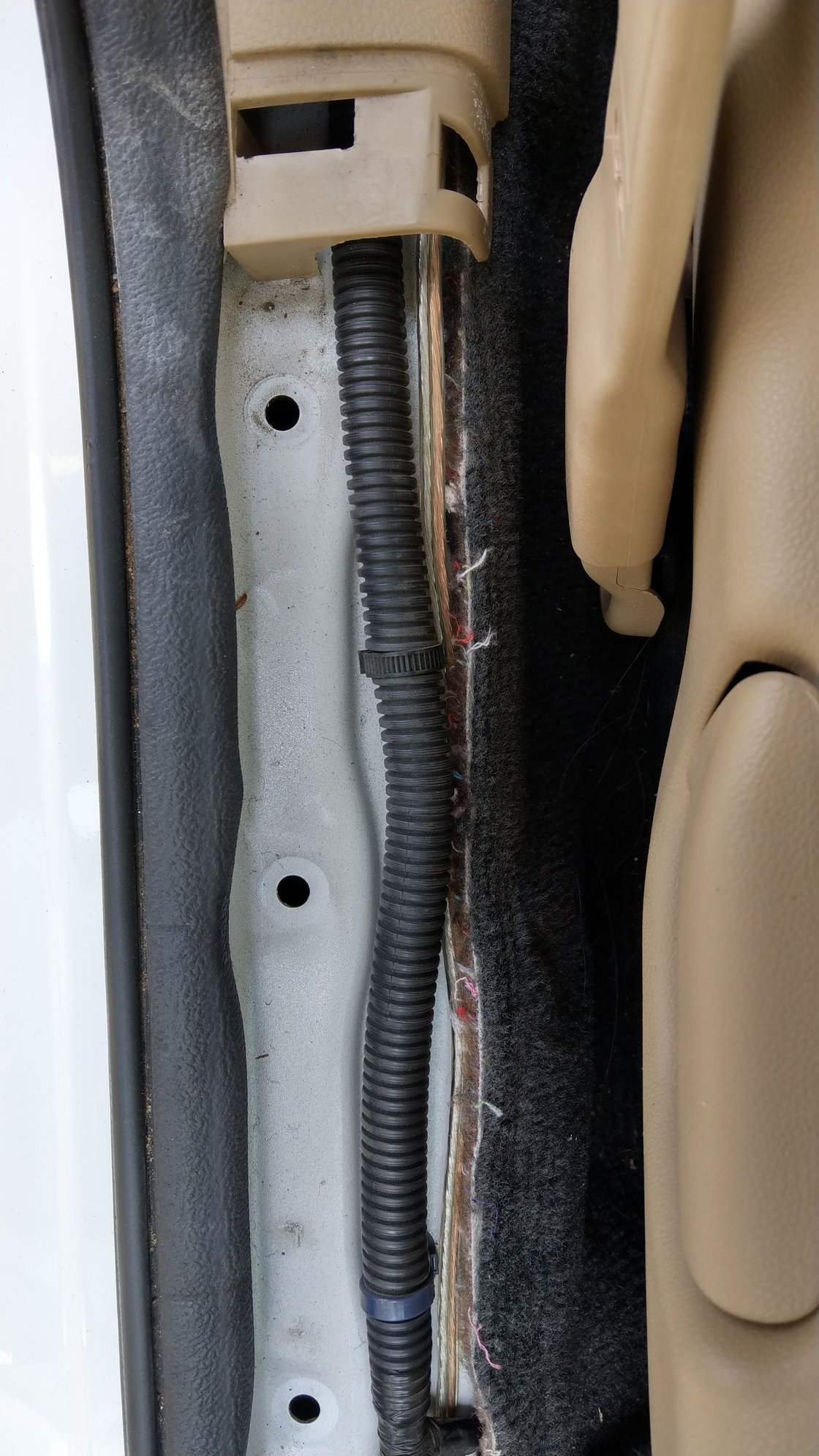

there 2 important clips here on the very low and very top left that we need to be careful with when we take it out

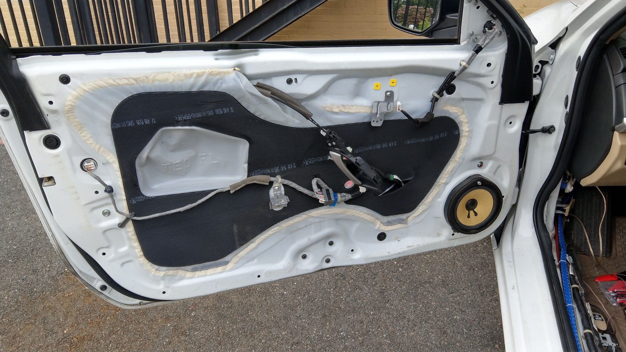

left door passing wire through factory cables
