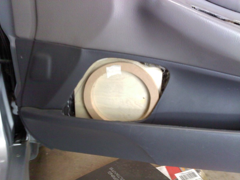

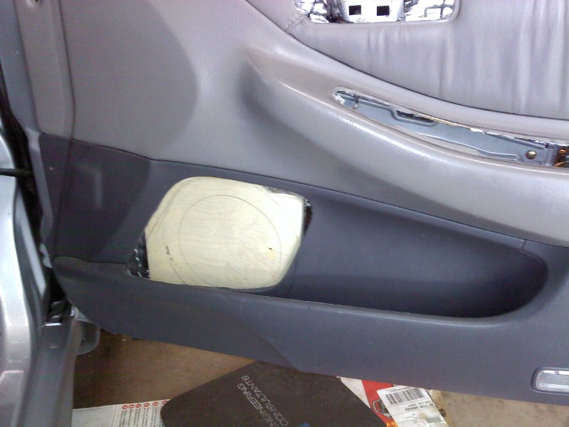

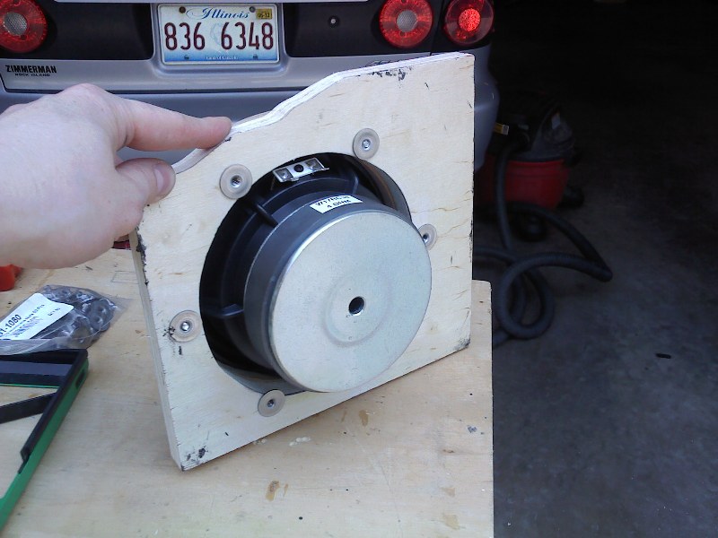

finally got around to putting the silver flute 6.5" midbass in the doors. required cutting metal, fabricating a new mount to make room for the massive basket/magnet, and cutting the door panel. next is making a new door panel grille to retain a factory look.
used 3/4" birch for the base and 1/2" MDF for the ring.
but you have to start somewhere, and that's with mockups. i previously removed the stock grill.
with ring to see future panel conflicts. depth required the door panel to be modified.

test fit
drilling holes
hurricane nuts 8-32
driver test fit
