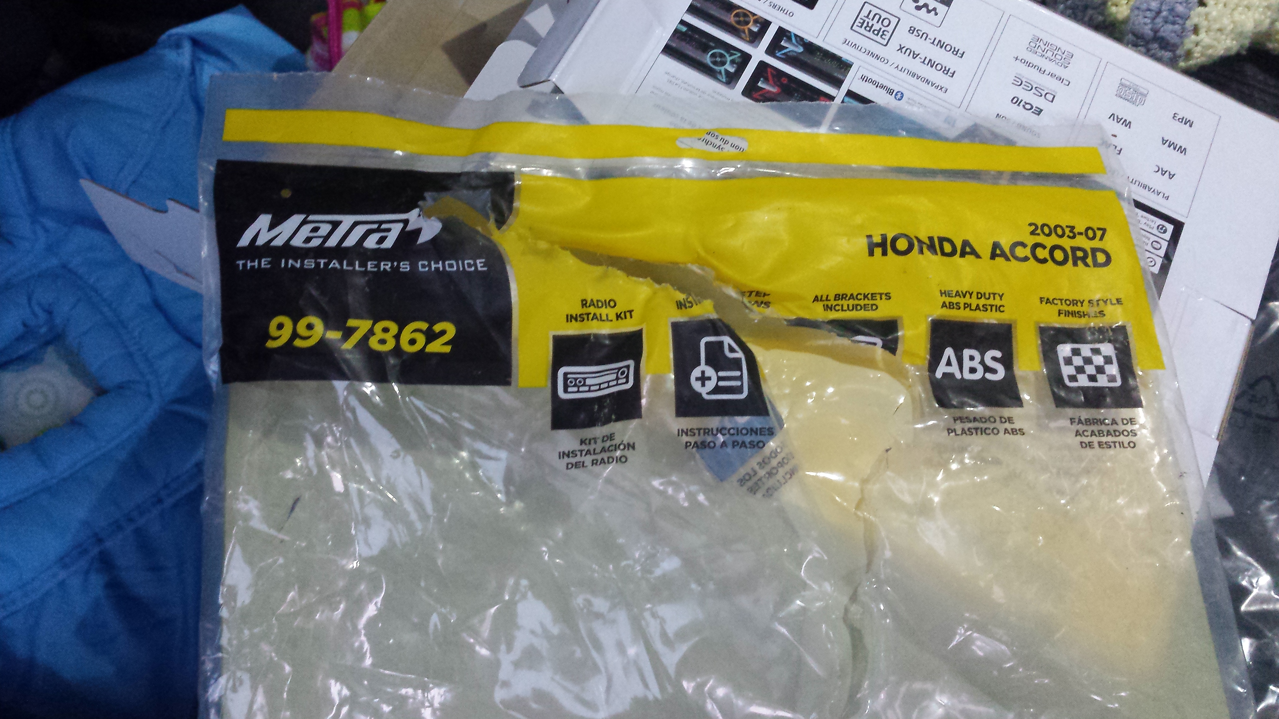

which wiring kit model number? how did the kit intersect the factory wiring? pics?
you will need to connect the blue/white wire on the Sony to the blue/white wire in the harness to turn on the factory amp.
That is the Metro kit I used for the install.

Just to let you know I figured out what the problem was. The metra wiring kit had either a bad wire on the constant 12 volt wire or it was cut somehow when they put it together. So I had to cut that bad piece out and put a new wire in it. Works fine now. Thanks for the help.
