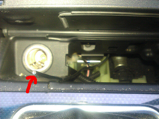

I took out the ask tray of my 2007 accord and noticed this loose wire, would anybody have any idea what its for?
It's shielded with maybe 4 cores, blue and red for sure and maybe a white and black.
The car has built in 6 cd changer and the DVD unit for the sat nav.
This wire is going in up the back of the center console
Attached Thumbnails Loose wire, any ideas what its for?-img_20120626_181249.jpg

Suggest getting all wire colors for sure.
I checked 2003-2007 Accord Shop Manual and found a 4-wire shielded set of wires running from Audoe HVAC Subdisplay Unit to Audio Unit. Wires were Yel/red, yel, blu/red, and blu. Shielding would clinch the Id, a fine mesh of wire surrounding the wire group.

is everything working properly? it looks like an antenna wire.

if it was FM antenna, it would have only one center conductor.
could be sat radio antenna.
