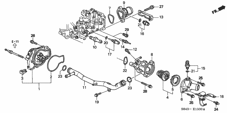

Parts drawing shows the fan switch still in in the thermostat housing. #15 in the picture.
Maybe 2001 or later they moved that??
