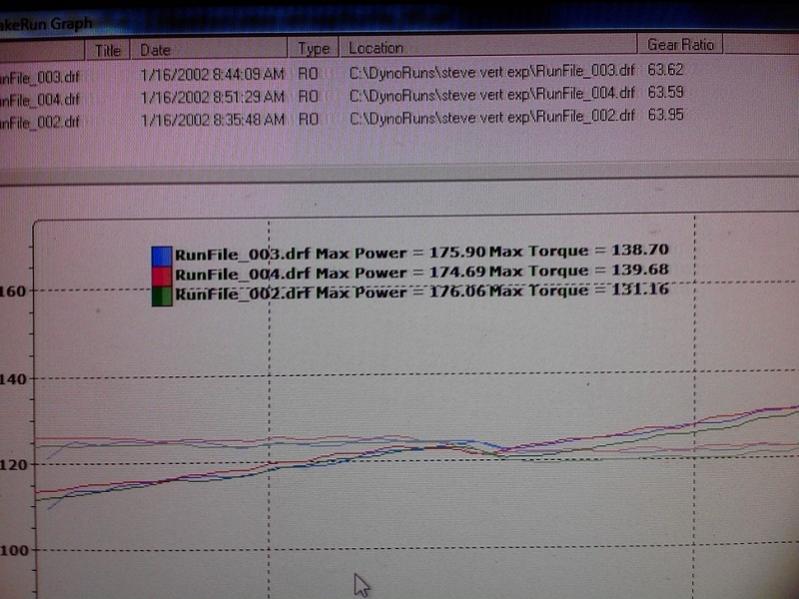

and these are the dyno results, so this is what that motor is worth at the wheels.
