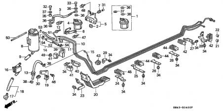

Old Feb 10, 2014 | 07:26 AM
See attached picture. 3-36-33.

Thank you---BUT---Is there a chart that explains the numbers?
My eyes are not that good...
Thanks again.
