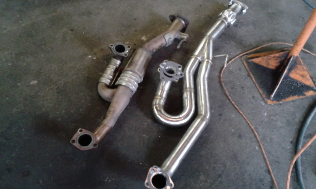

Anyone who has an XLR8 j-pipe will tell you the improvements are noticeable and permanent. There are guys on v6performance putting down 250 to 270 hp at the wheels with j-pipe, pre-cat deletes, J35/37 intakes, port and polish lower runners and TBs, 4" cold air intakes, etc and running well into the 13s. And that's on the stock cams. Those using TL-S heads/cams are making even more. Honda J series engines have a lot more potential than people realize. And if your mods exceed the ECU's ability to handle, there are aftermarket solutions like Hondata.
Do you really think going from the stock j-pipe on the left to the XLR8 v2 pipe on the right is really only going to be worth 2-3 hp?
By moving the merge back, its basically the same effect as lengthening the collector on a set of headers. Big gains in torque, which is what Honda engines really need.

nice description and picture, i bet it would be a vast improvment.
