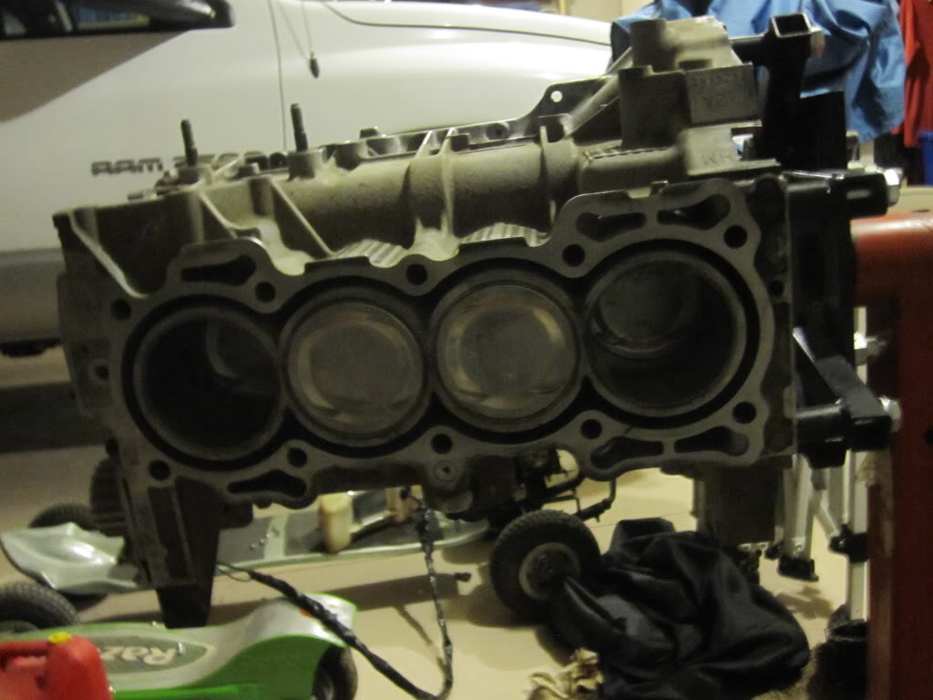

the pistons are all in now.

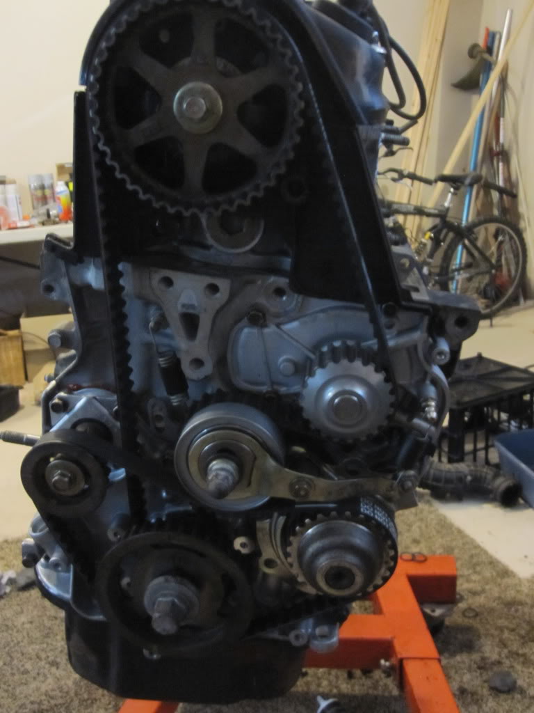

timing in and suprisingly it was perfect when i started it. makes me so happy.

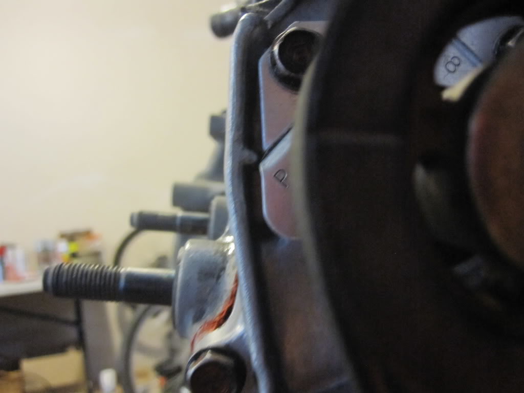

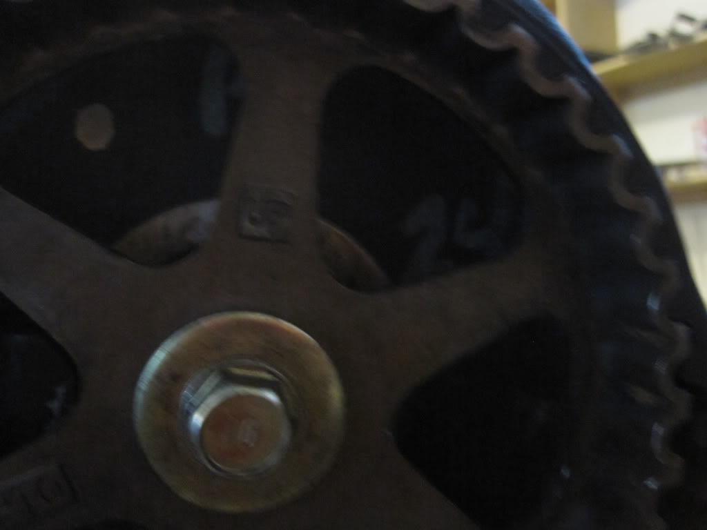

says up all i have to say it get it as up as you can get it it doesn't have any marks at all... So helpful honda sometimes I want to destroy you for being complicated but it seems to last forever so i won't also 27ft-lbs for the camshaft bolt but what i found our was that once it was finally torqued the camshaft started rotating so I'd say its safe to just tighten it till the camshaft starts turning... but I still recommend you use the right tools in case i'm wrong I don't want your engine to fall apart. I'm not responsible for anything you do with your engine, try all of this at your own risk.

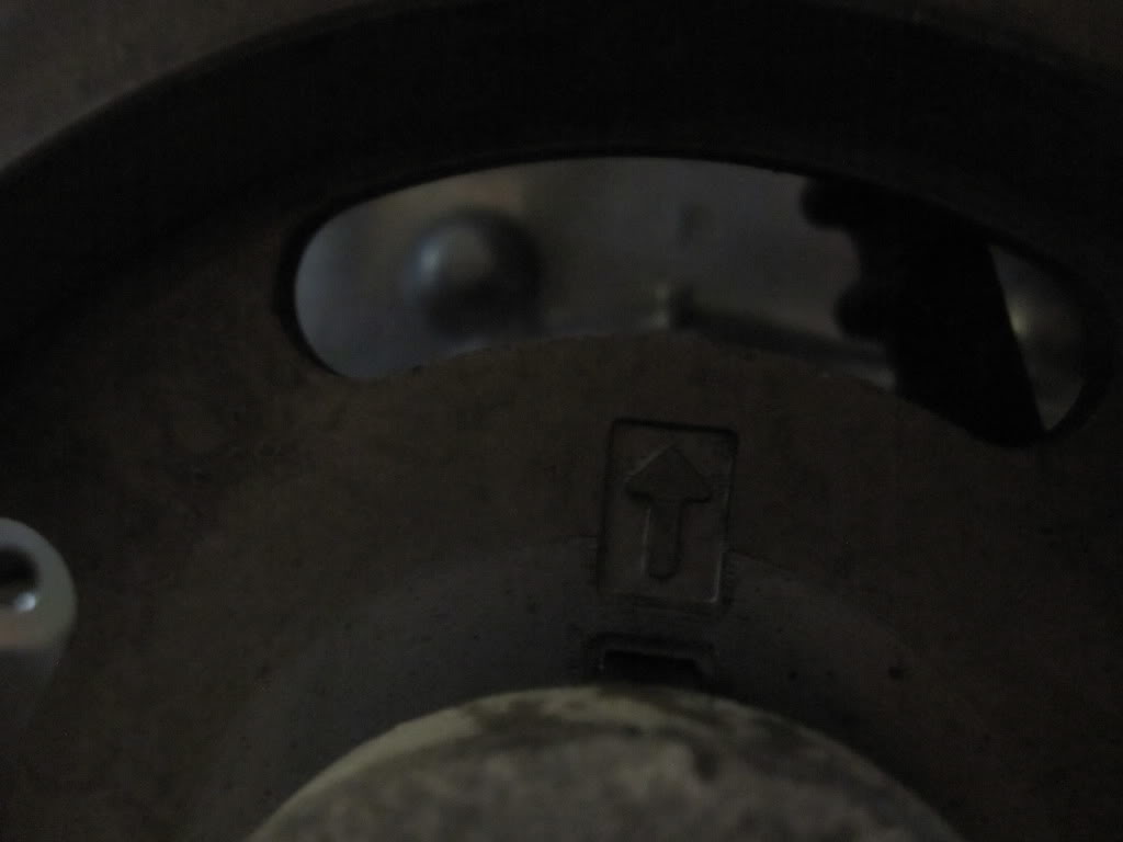

the is a little line that i lined up with the bump on the oil pump... it seem to have done the trick.

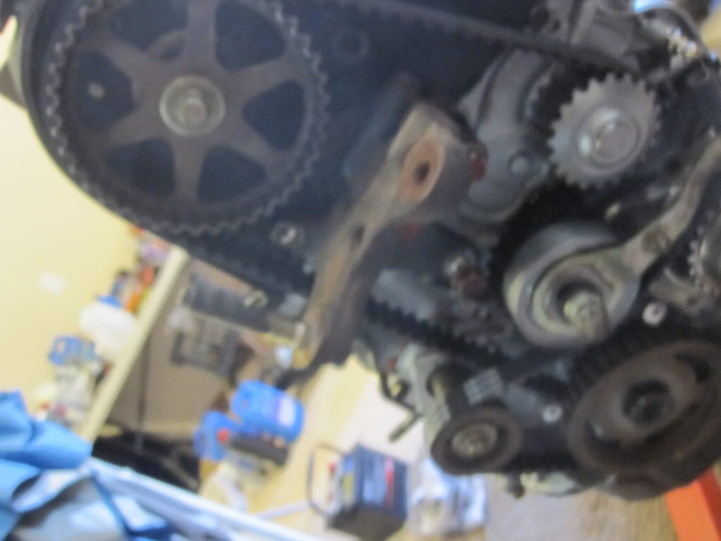

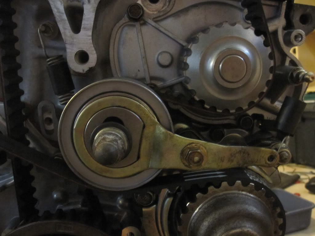

31ft lbs for the bolt on the tensioners and there are springs to help tighten the belts. so helpful
